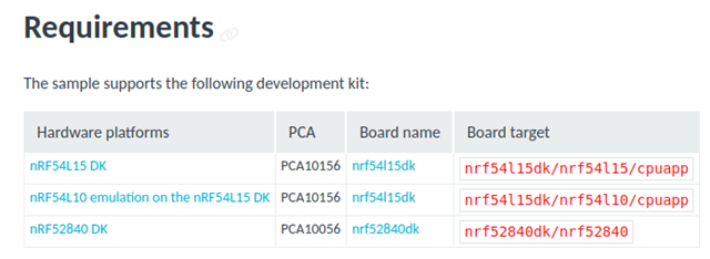

    I have also nRF52840 DKs that, I think, work directly with the sample apps, is this correct?
    Yes, the nRF52840 DK is supported out of the box. You can see which development kits are supported under the requirements section in the documentation for each sample:
    The samples might also work with other boards, but the boards listed are the ones we test.
