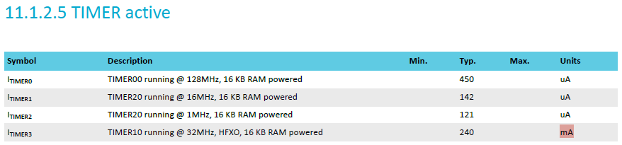

nRF54L15 TIMER active Current Consumption - Typo in specification?
The specification for the nRF54L15 states that the typical current consumption for I_TIMER3 (TIMER10 running) is 240mA/milliamps. The other timer values in the table are shown as uA/microamps. It looks like this is just a typo, but I am looking for confirmation. Thank you!
Current consumption
