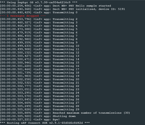

I've installed and begin to experiment with the DECT NR+ v1.1.1.0 FW.  Initially, I'm noticing on obvious difference in the behavior of the dect_hello sample between v1.0.2 of the FW and v1.1.0.  With v1.0.2, the "hello" messages are sent at 5 sec intervals, as configured in the RX_PERIOD_S var in the Kconfig file.  However, when the same dect_hello sample is run using v1.1.0 of the FW, it seems to almost not wait at all (less than 1 ms) between transmissions.  It seems to wait very little time to try to receive a packet before moving on the next transmission.
My output from v1.1.0 + hello_dect is the following:
To observe this issue, pls do the following:
1. Load v1.0.2 of FW
2. Load dect_hello
3. Execute and observe the interdeparture time of 5 sec.
4.   Load v1.1.0 of FW
5.. Load dect_hello
6. Execute and observe the interdeparture time of less than 1  ms.
Pls let me know if there is anything I can do that can fix this.
Thanks!
Best,
Steven Gordon

    I can see the same result on my side. I programmed the hello_dect sample from NCS v2.9.1 and see the same issue with dect modem fw.
    mfw-nr+_nrf91x1_1.1.0-47.alpha
    *** Booting nRF Connect SDK v2.9.1-60d0d6c8d42d ***
    *** Using Zephyr OS v3.7.99-ca954a6216c9 ***
    [00:00:00.292,907] <inf> app: Dect NR+ PHY Hello sample started
    [00:00:00.479,370] <inf> app: Dect NR+ PHY initialized, device ID: 13309
    [00:00:00.479,431] <inf> app: Transmitting 0
    --- 1 messages dropped ---
    [00:00:00.492,797] <inf> app: Transmitting 2
    [00:00:00.499,328] <inf> app: Transmitting 3
    [00:00:00.505,859] <inf> app: Transmitting 4
    [00:00:00.512,390] <inf> app: Transmitting 5
    [00:00:00.518,920] <inf> app: Transmitting 6
    [00:00:00.525,451] <inf> app: Transmitting 7
    [00:00:00.531,982] <inf> app: Transmitting 8
    [00:00:00.538,360] <inf> app: Transmitting 9
    [00:00:00.538,635] <inf> app: Transmitting 10
    [00:00:00.538,909] <inf> app: Transmitting 11
    [00:00:00.539,154] <inf> app: Transmitting 12
    [00:00:00.539,428] <inf> app: Transmitting 13
    [00:00:00.539,672] <inf> app: Transmitting 14
    [00:00:00.539,947] <inf> app: Transmitting 15
    [00:00:00.540,191] <inf> app: Transmitting 16
    [00:00:00.540,466] <inf> app: Transmitting 17
    [00:00:00.540,710] <inf> app: Transmitting 18
    [00:00:00.540,985] <inf> app: Transmitting 19
    [00:00:00.541,259] <inf> app: Transmitting 20
    [00:00:00.541,503] <inf> app: Transmitting 21
    [00:00:00.541,778] <inf> app: Transmitting 22
    [00:00:00.542,022] <inf> app: Transmitting 23
    [00:00:00.542,297] <inf> app: Transmitting 24
    [00:00:00.542,541] <inf> app: Transmitting 25
    [00:00:00.542,816] <inf> app: Transmitting 26
    [00:00:00.543,670] <inf> app: Transmitting 27
    [00:00:00.544,250] <inf> app: Transmitting 28
    [00:00:00.544,830] <inf> app: Transmitting 29
    [00:00:00.544,891] <inf> app: Reached maximum number of transmissions (30)
    [00:00:00.544,921] <inf> app: Shutting down
    [00:00:00.566,162] <inf> app: Bye!

  • Hi Steven, our DECT team informed me that there has been some API changes and thus you must use nRF Connect SDK v3.0.0 with mfw-nr+_nrf91x1_1.1.0-47.alpha.
    Can you please test and let me know how that works?
    Kind regards;
    Øyvind
  • Øyvind,
    I tried it and it does work.  Thanks for the insight.
    However, in the process of trying this, I discovered something I don't understand.  After upgrading to sdk 3.0.0 and toolchain 3.0.0, I used the existing dect_hello project (which was created with sdk 2.9.1) and created a new build configuration where I specified sdk 3.0.0 and toolchain 3.0.0.  This build consistently failed, ever after reinstalling all fo the components of the NRF Connect environment.
    However, when I recopied the hello_dect sample using sdk 3.0.0 (rather than using the project created under sdk 2.9.1 with a new 3.0.0 build config), it did build and flash properly.  Can you tell me why this is?
    Thank you.
