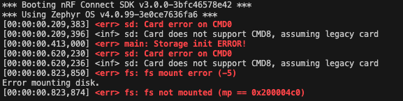

And When activating the SD logs these are the logs generated
*** Booting nRF Connect SDK v2.9.1-60d0d6c8d42d ***
*** Using Zephyr OS v3.7.99-ca954a6216c9 ***
[00:00:00.429,620] <inf> main: Starting program
[00:00:00.429,626] <inf> hardware: Power on mic and SD card is set !
[00:00:00.429,634] <inf> fatfs: Disk Status: 1
[00:00:00.433,221] <dbg> sdhc_spi: sdhc_spi_send_cmd: cmd0 arg 0x0
[00:00:00.454,282] <dbg> sdhc_spi: sdhc_spi_send_cmd: cmd8 arg 0x1aa
[00:00:00.455,001] <dbg> sdhc_spi: sdhc_spi_send_cmd: cmd0 arg 0x0
[00:00:00.455,716] <dbg> sdhc_spi: sdhc_spi_send_cmd: cmd8 arg 0x1aa
[00:00:00.476,960] <dbg> sdhc_spi: sdhc_spi_send_cmd: cmd0 arg 0x0
[00:00:00.477,688] <dbg> sdhc_spi: sdhc_spi_send_cmd: cmd8 arg 0x1aa
[00:00:00.478,404] <dbg> sdhc_spi: sdhc_spi_send_cmd: cmd0 arg 0x0
[00:00:00.499,401] <dbg> sdhc_spi: sdhc_spi_send_cmd: cmd8 arg 0x1aa
[00:00:00.500,130] <dbg> sdhc_spi: sdhc_spi_send_cmd: cmd0 arg 0x0
[00:00:00.500,844] <dbg> sdhc_spi: sdhc_spi_send_cmd: cmd8 arg 0x1aa
[00:00:00.522,123] <dbg> sdhc_spi: sdhc_spi_send_cmd: cmd0 arg 0x0
[00:00:00.522,854] <dbg> sdhc_spi: sdhc_spi_send_cmd: cmd8 arg 0x1aa
[00:00:00.523,573] <dbg> sdhc_spi: sdhc_spi_send_cmd: cmd0 arg 0x0
[00:00:00.544,587] <dbg> sdhc_spi: sdhc_spi_send_cmd: cmd8 arg 0x1aa
[00:00:00.545,306] <dbg> sdhc_spi: sdhc_spi_send_cmd: cmd0 arg 0x0
[00:00:00.546,023] <dbg> sdhc_spi: sdhc_spi_send_cmd: cmd8 arg 0x1aa
[00:00:00.567,294] <dbg> sdhc_spi: sdhc_spi_send_cmd: cmd0 arg 0x0
[00:00:00.568,011] <dbg> sdhc_spi: sdhc_spi_send_cmd: cmd8 arg 0x1aa
[00:00:00.568,730] <dbg> sdhc_spi: sdhc_spi_send_cmd: cmd0 arg 0x0
[00:00:00.589,739] <dbg> sdhc_spi: sdhc_spi_send_cmd: cmd8 arg 0x1aa
[00:00:00.590,461] <dbg> sdhc_spi: sdhc_spi_send_cmd: cmd0 arg 0x0
[00:00:00.591,178] <dbg> sdhc_spi: sdhc_spi_send_cmd: cmd8 arg 0x1aa
[00:00:00.612,440] <inf> sd: Card does not support CMD8, assuming legacy card
[00:00:00.612,457] <dbg> sdhc_spi: sdhc_spi_send_cmd: cmd0 arg 0x0
[00:00:00.613,173] <dbg> sdhc_spi: sdhc_spi_send_cmd: cmd58 arg 0x0
[00:00:00.613,988] <dbg> sdhc_spi: sdhc_spi_send_cmd: cmd55 arg 0x0
[00:00:00.635,017] <dbg> sdhc_spi: sdhc_spi_send_cmd: cmd41 arg 0x0
[00:00:00.635,733] <dbg> sdhc_spi: sdhc_spi_send_cmd: cmd58 arg 0x0
[00:00:00.636,444] <inf> fatfs: DISK Acces init code -134
[00:00:00.636,450] <err> fatfs: Storage init ERROR! error: -134
[00:00:00.640,102] <dbg> sdhc_spi: sdhc_spi_send_cmd: cmd0 arg 0x0
[00:00:00.671,241] <dbg> sdhc_spi: sdhc_spi_send_cmd: cmd8 arg 0x1aa
[00:00:00.671,958] <dbg> sdhc_spi: sdhc_spi_send_cmd: cmd0 arg 0x0
[00:00:00.672,675] <dbg> sdhc_spi: sdhc_spi_send_cmd: cmd8 arg 0x1aa
[00:00:00.693,923] <dbg> sdhc_spi: sdhc_spi_send_cmd: cmd0 arg 0x0
[00:00:00.694,636] <dbg> sdhc_spi: sdhc_spi_send_cmd: cmd8 arg 0x1aa
[00:00:00.695,352] <dbg> sdhc_spi: sdhc_spi_send_cmd: cmd0 arg 0x0
[00:00:00.716,393] <dbg> sdhc_spi: sdhc_spi_send_cmd: cmd8 arg 0x1aa
[00:00:00.717,112] <dbg> sdhc_spi: sdhc_spi_send_cmd: cmd0 arg 0x0
[00:00:00.717,827] <dbg> sdhc_spi: sdhc_spi_send_cmd: cmd8 arg 0x1aa
[00:00:00.739,104] <dbg> sdhc_spi: sdhc_spi_send_cmd: cmd0 arg 0x0
[00:00:00.739,819] <dbg> sdhc_spi: sdhc_spi_send_cmd: cmd8 arg 0x1aa
[00:00:00.740,533] <dbg> sdhc_spi: sdhc_spi_send_cmd: cmd0 arg 0x0
[00:00:00.761,545] <dbg> sdhc_spi: sdhc_spi_send_cmd: cmd8 arg 0x1aa
[00:00:00.762,260] <dbg> sdhc_spi: sdhc_spi_send_cmd: cmd0 arg 0x0
[00:00:00.762,977] <dbg> sdhc_spi: sdhc_spi_send_cmd: cmd8 arg 0x1aa
[00:00:00.784,227] <dbg> sdhc_spi: sdhc_spi_send_cmd: cmd0 arg 0x0
[00:00:00.784,942] <dbg> sdhc_spi: sdhc_spi_send_cmd: cmd8 arg 0x1aa
[00:00:00.785,660] <dbg> sdhc_spi: sdhc_spi_send_cmd: cmd0 arg 0x0
[00:00:00.806,698] <dbg> sdhc_spi: sdhc_spi_send_cmd: cmd8 arg 0x1aa
[00:00:00.807,412] <dbg> sdhc_spi: sdhc_spi_send_cmd: cmd0 arg 0x0
[00:00:00.808,126] <dbg> sdhc_spi: sdhc_spi_send_cmd: cmd8 arg 0x1aa
[00:00:00.829,370] <inf> sd: Card does not support CMD8, assuming legacy card
[00:00:00.829,387] <dbg> sdhc_spi: sdhc_spi_send_cmd: cmd0 arg 0x0
[00:00:00.830,104] <dbg> sdhc_spi: sdhc_spi_send_cmd: cmd58 arg 0x0
[00:00:00.830,921] <dbg> sdhc_spi: sdhc_spi_send_cmd: cmd55 arg 0x0
[00:00:00.851,978] <dbg> sdhc_spi: sdhc_spi_send_cmd: cmd41 arg 0x0
[00:00:00.852,692] <dbg> sdhc_spi: sdhc_spi_send_cmd: cmd58 arg 0x0
[00:00:00.853,403] <err> fs: fs mount error (-5)
[00:00:00.853,411] <inf> main: Error mounting disk.
[00:00:00.853,423] <err> fs: fs not mounted (mp == 0x20000008)
[00:00:00.853,429] <inf> main: Exiting program.

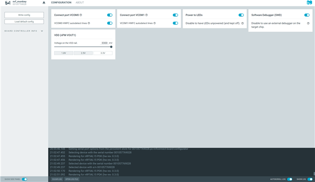

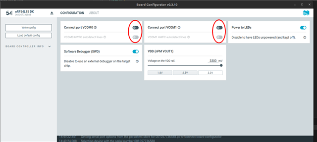

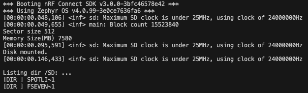

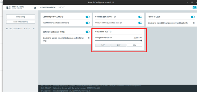

    Before I try to reproduce this on my desk, please try increasing the IO voltage to 3.3v if you haven't done so already. The default voltage is 1.8v and may not be supported by your SD card. The IO voltage is adjusted by changing the VDD in the board configurator app in nRF Connect for Desktop:
    Vidar
  • Hello thank you for your answer, as you predicted the default volatage was indeed set 1.8V.
    However i still encounter the same issue after setting the voltage to 3.3V as described in the logs of the original post.
    Thanks
    Nabil

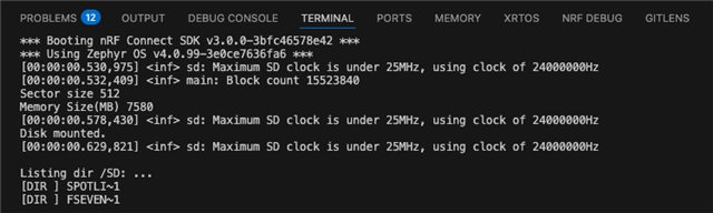

    Could you please try with the .hex I uploaded earlier and with this pinout:
    Vidar

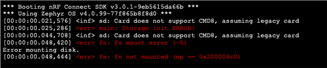

  • Hi Vidar,
    I already did, but here is the RTT output with the .hex and pinout provided:

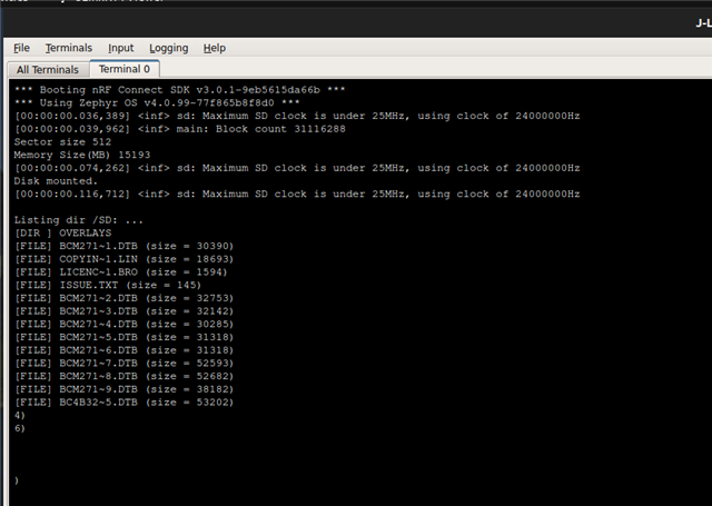

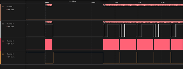

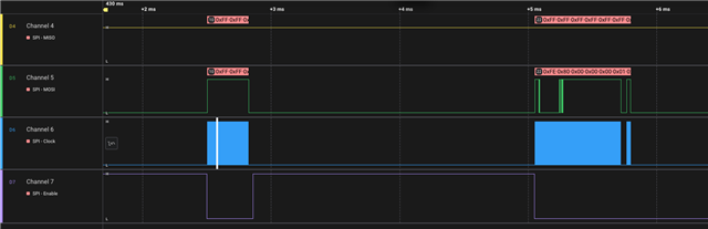

    I was hoping testing with my FW would help narrow down the problem. The error indicates that the SD card is not responding to the commands.
    So to summarize:
    1. The same SD card works with the nRF5340 DK which confirms that the card is compatible with the driver.
    2. Both setups are operating at the same IO voltage level.
    3. The identical firmware works on my desk.

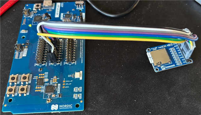

    From the board picture you posted it looks like you have changed which pins are connected to the SD card module compared to the overlay Nabil included in the initial post? Have you tried to probe the lines with a scope or logic analyzer?
  • Hi Vidar,
    It seems that the pins are well configured, according to the .overlay.
    • P1.04 : SD_SCK
    • P1.05 : SD_MISO
    • P1.07 : SD_MOSI
    • P1.06 : SD_nCS
    &spi20 {
        status = "okay";
        pinctrl-0 = <&spi20_default>;
        pinctrl-1 = <&spi20_sleep>;
        cs-gpios = <&gpio1 6 GPIO_ACTIVE_LOW>; // P1.06 - SD_nCS
    	sdhc0: sdhc@0 {
    		compatible = "zephyr,sdhc-spi-slot";
    		reg = <0>;
    		status = "okay";
    		mmc {
    			compatible = "zephyr,sdmmc-disk";
    			disk-name = "SD";
    			status = "okay";
    		spi-max-frequency = <24000000>;

    With the logic analyzer :
    • nrf54L15
    • nrf5340
    The GPIOs seem to be correctly assigned. However, the SPI frames are not the same.
    • Is there anything special to do with the nRF54L15 in terms of hardware?
    • Or a special configuration to put in the prj.conf?
    Kind Regards
    Patrice
  • Hi Patrice,
    Sorry, I didn't think of this earlier since it was working fine on my end, but I suspect the issue is that P1.04 through P1.07 are connected to the interface MCU on the board, which is likely interfering with the SPI transfers. You can see the pin assigments by looking at the silkscreen on the backside of the board.
    Fortunately, it is possible to disconnect these lines through the board configurator. Please try that.
    Vidar
    Log from my test
  • Hi Patrice,
    Vidar
    Log from my test
