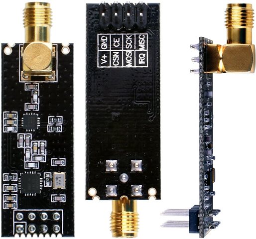

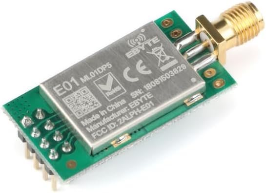

FYI this is the device I'm using, purchased a few years ago and just sitting in my workshop.

    These are the devices that failed.
    These are the devices that worked and appear to be manufactured using genuine Nordic sourced chips.
    So this confirms 100% there are devices out there in the market that work fine for some functions but simply do not work with auto-ack.
