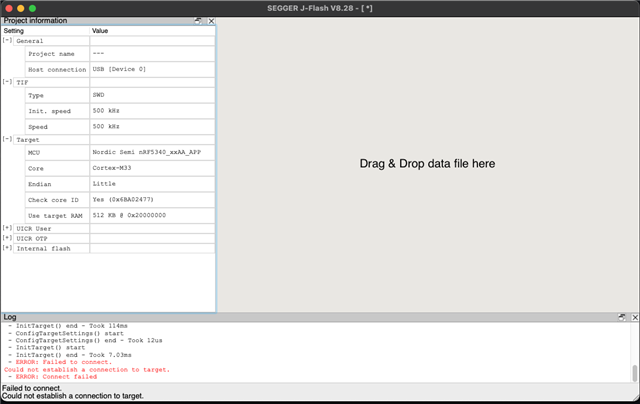

I am using custom board with MDBT53 and I'm stuck at a point where board does not even let me to connect the debugger so that I can refresh firmware.
I added MCU boot code into my existing firmware and once I flashed this mcu boot code to my board I got my board into state that its not powering up the board and not letting me to connect the debugger. When I try to flash the code via JFlash v8.28 it gives following error.

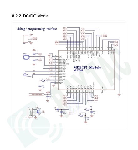

    Foes you custom board use DCDC or LDO mode of operation?
    If you do not have the DCDC external components in place you will "brick" the device.
    Form the Raytac docs, see the recommended circuit for the DCDC mode.
    Jonathan
    Thanks for quick response. I am not sure about the circuit but I know from my colleagues that we have explicitly disabled it in the code. like this
    # disable DCDC
    CONFIG_BOARD_ENABLE_DCDC_APP=n
    CONFIG_BOARD_ENABLE_DCDC_NET=n
    CONFIG_BOARD_ENABLE_DCDC_HV=n
    I haven't done anything with code but added bootlaoder code into the current version of code and then this happened. So one thing I dont understand is why the device goes to this state as I have never seen something like this before as I did work on mcu boot serval times.

    To recover a board that has the been flashed with the wrong firmware you would need to supply the external pins related to DCC with power or at least get it in a state before it shuts down due to the wrong regulators being enabled. In many cases the device is bricked as the pins are not always accessible. If that is the case then it needs to be removed and either replaced or mounted to a board where all pins are available and re-programed\recovered.
    Since you have a module you should be able to access the pins connected to the different regulators so this could possibly be solved.
    In the code when you compile it you should be able to see if the registers for the regulators are on or off before you flash it to the device. There should be a Zephyr.dts file that is generated, maybe for the bootloader.
    It might be that the bootloader overwrites the configs if not done correctly.
