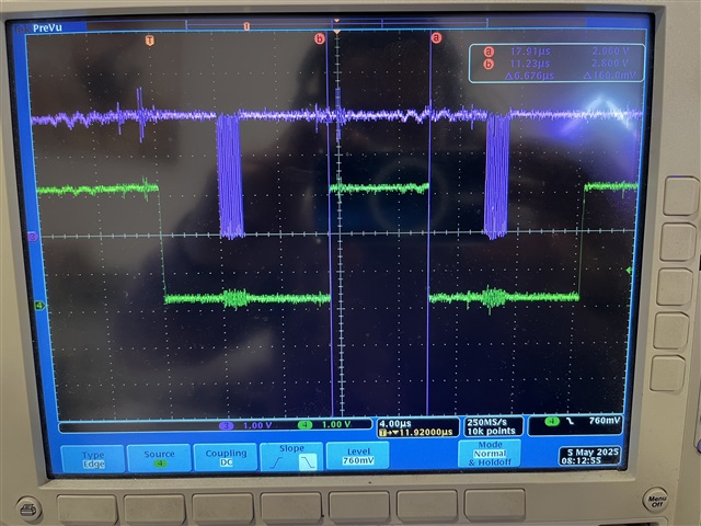

We have a project where we are using the nRF52840 with the ADS7052 (an ADC) on the SPI bus. We are using Zephyr 4.1.0, but I guess its same same with nRF Connect SDK.
We need to read the ADC samples very fast, therefore I am using nrfx_spim directly.
The ADS7052 ADC sample readout works (simplified) as follows:
- falling edge of CS Pin, then read 3 bytes.
for another sample, we have to drive cs pin high and then go low again etc.
I tried to test that on the nRF52840DK. Read 10 samples, wait 2 seconds, repeat:

on the oscilloscope, in green the cs pin, and in violet the SCLK.
It takes quiet a few us (4us) for the SCLK to start after the falling edge of CS. Also it takes very long (5.7us) for the cs pin to go high, when SCLK stops.
it takes about 6.6us for CS to go low again.
Reading the 10 samples is very slow, as we need to be faster. Are there any improvements I can make?
