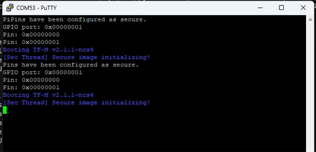

  • Hello Ladivin,
    I have tried to run your attached sample on nRf5340DK and I was able to run the sample. There were some warnings related to warning: implicit declaration of function 'lv_iter_destroy' [-Wimplicit-function-declaration].
    Adding the following header files in the main.c file, solved the issue
    #include <lvgl.h>
    #include <zephyr/device.h>
    #include <zephyr/devicetree.h>
    #include <zephyr/drivers/display.h>
    This is the output I got
    I have not seen any other way to fix this issue. I have asked team. I will get back to you soon.
