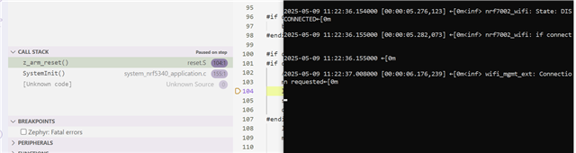

  • we have upgraded to nRF Connect SDK v2.6.4 on our nRF7002 DK (nrf5340). However, we are encountering an issue where the device undergoes an unknown reset repeatedly after a connection request. Issue Description: After initiating a connection request, the device resets unexpectedly and continuously at the same point and reproducible. The issue did not occur in the previous SDK version (v2.6.1).

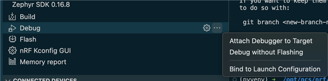

    It looks like you are using RTT for logging and receiving an assertion or fault.
    First, lets enable blocking assert/faults:
    CONFIG_RESET_ON_FATAL_ERROR=n
    If you still do not see any assert output on RTT, could you please enter debug mode and share the callstack?
    Håkon

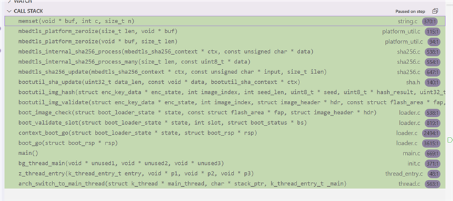

  • We are using UART for logging. As you mentioned, we have disabled CONFIG_RESET_ON_FATAL_ERROR to prevent a reset from occurring. We have attached a screenshot that includes the log and call stack.
    That callstack does not seem to hold anything useful, looks like it is from after a reset has occurred.
    Did you attach without resetting the target after it faulted?
    Håkon
