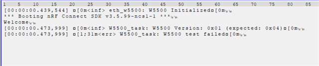

I am using  NRF52840 dk  evaluation board  Arduino ethernet shield which has W5500 ethernet chip and  for my development purpose using SDK 2.6.1 on visual studio code.
I am trying to read W5500 version register but always getting the wrong output. Can you check my code and tell me what can be wrong.

  • From what I can see, everything looks correct in regards to the connection / board configuration. As there are no errors during the build phase and the start indicate that the W5500 is initialized.
    [00:00:00.259,002] <inf> eth_w5500: W5500 Initialized
    *** Booting nRF Connect SDK v3.5.99-ncs1-1 ***
    [00:00:00.293,426] <inf> W5500_task: W5500 Version: 0x01 (expected: 0x04)
    [00:00:00.293,426] <err> W5500_task: W5500 test failed
    This would indicate an issue with the W5500 driver. Did you look at zephyr\drivers\ethernet\eth_w5500_priv.h and zephyr\drivers\ethernet\eth_w5500.c?
