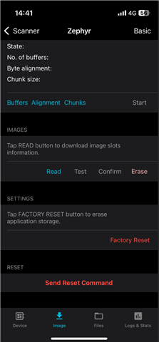

    Perhaps your device is in "testing mode" of the new application, and hence, it can't delete the old application image before the new one is marked as verified. I understand that the JTAG connection is not available, but is there some way to reset your device? When you do, does it restart the same application that it is running, or the previous version?
    If you don't have any way to reset it, I see that you can issue a reset command using SMP.
    Note that I had to press the button where it now says "Basic", where it used to say "Advanced" before I pressed it. Then it should show you the "Send Reset Command" at the bottom. Try this, and see whether the app rolls back to the previous version, or if you are able to do a new DFU after this.

  • You can also try to tap the "Read" from my previous screenshot, and see what it says.

    I actually had already given that a shot, and we found a way to get the application core image to be put into the primary slot. When we clicked "read", we saw that there were two images, the primary and secondary. When I clicked "erase", the secondary image was erased, and only one image was left, the primary image. I then attempted to upload an image, experienced the error, and then clicked "read" again and saw that there were now two images in place. I then clicked "test" to move the secondary image to the primary slot, clicked "confirm" to confirm the secondary image to the primary slot, and then I clicked "reset" to reset the device. The application core image was successfully moved to the primary slot.

    Rebooting will not erase the second image in itself. But it will revert back to the old image, if the new one was not confirmed. Then you can choose whether you want to test the new image again, or if you want to delete it and upload another.
    I believe the issue was that you were running an unconfirmed image, and hence, it couldn't delete the only confirmed image that it had (which was currently placed in slot 1 (the running image is always in slot 0, even though it is not confirmed).
    So if you were to reboot, it would boot up the old confirmed image (after swapping it back to slot 0), and slot 1 would still contain the unconfirmed image, until you either manually erase it using mcumgr, or until you try to upload a new image.
