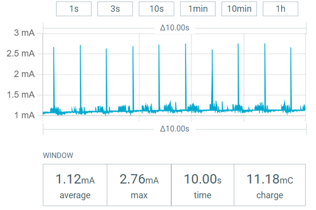

So whatever I try, the only way to get my idle current consumption to an acceptable low value is to set CONFIG_SERIAL=n in my configuration. But then I don't get printk functionality. The lowest I can achieve using a nRF52DK & PPK2 is about 1mA, compared to 7uA with CONFIG_SERIAL=n.

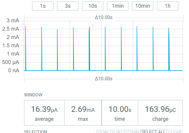

  • I see. It is not possible to enable RX with this property set in the Devicetree. However, if you set CONFIG_PM_DEVICE=y in your configuration, you can use the "suspend" and "resume" action to control when the uart is to be enabled and disabled.
    #include <zephyr/pm/device.h>
    static struct device const *uart_dev = DEVICE_DT_GET(DT_CHOSEN(zephyr_console));
    	/* Disable UART to reduce System ON idle current */
    	err = pm_device_action_run(uart_dev, PM_DEVICE_ACTION_SUSPEND);
    	if (err) {
    		printk("UART suspend failed. (err %d)\n", err);
    		return 1;
  • Thank you, that's much better!! I tried it using the Hello World example for simplicity - now I get 16uA vs 1.1mA
