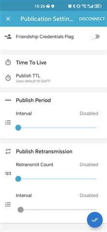

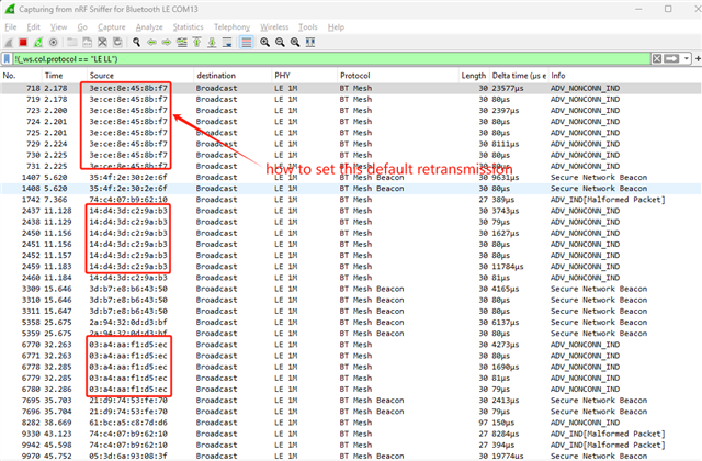

 i set publication retransmission time for 0 in andriod mesh app, and here is the sniffer log:
my question is
1.why mac address is changing everytime device send the message after i pressed the button, is there  any document about this?
2.how to set the default trasmission(seems it is 3 internally) , if customer want to set this to 4 or 5

    The address is changing for privacy reasons. If you, however, for debugging purposes, want to keep using the same address, you can set CONFIG_BT_MESH_DEBUG_USE_ID_ADDR=y in prj.conf. This is not recommended for production. From NCS\zephyr\subsys\bluetooth\mesh\Kconfig:

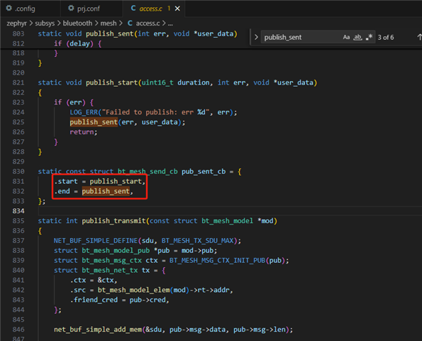

    [00:03:45.292,144] [0m<dbg> bt_mesh_access: mod_publish: timestamp: 225292[0m
    [00:03:45.350,677] [0m<dbg> bt_mesh_access: publish_sent: err 0, time 225350[0m
    [00:03:45.350,708] [0m<dbg> bt_mesh_access: next_period: Publishing took 58ms[0m
    static const struct bt_mesh_send_cb pub_sent_cb = {
        .start = publish_start,
        .end = publish_sent,
    so everytime button pressed, the time i from publish_start to publish_sent callback  tooks 58ms and send the channel37,38,39 for three times internally.
    how can we change it?
    William.

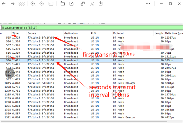

  • hi Edvin,
    if those are set, it would be as below:
    what i ask is the time cost inside  the first transmit.
    William.
