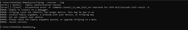

    Can you try to use nRF Command line Tools and do a recover? If it fails, can you add the --log argument and share the log with us?
    Make sure that the device is powered when doing this.
    nrfjprog --recover --log

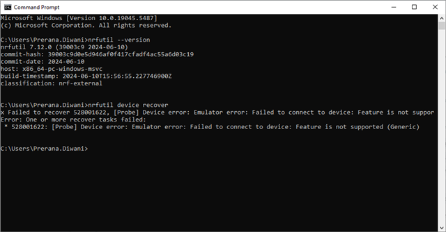

  • Already tried this , error throws. It was using nrf54l15-Dk external debugger output port

    Thanks for the log. I've shared it with our developers and the error in the latest log is not the same as the one you've shared here
    Khodidas11 said:
    We tried response is as attached
    The error in the picture comes from the J-Link sw when we try to use J-link to connect to the chip.
    The error in the log indicates that the debug port is unavailable, which should normally work with a functional device.

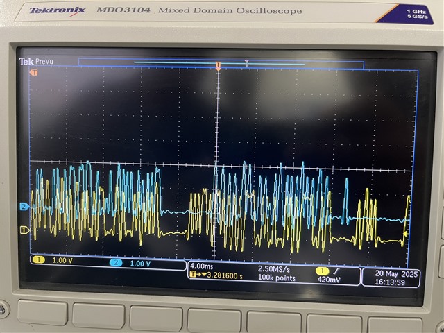

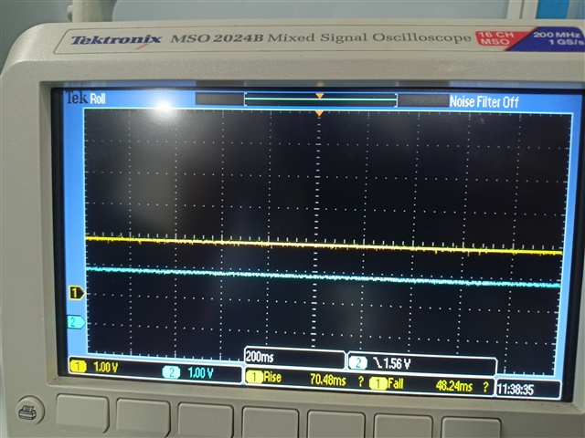

    We changed to different system to work and getting same error as per log file. Please check attached waveforms for VDD and RESET. We checked on two different PCBs, and got same result.

    Ok, looks like both RESET and VDD is at around 1V8.
    Could you share your schematics and layout?
    Could you also probe the SWD signals and share a trace when you try to run recover command?

    We tried with 1.8 as well as 3.3 both supply and results are same.
