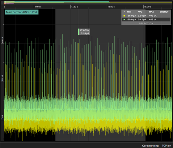

    Enabling the interrupt with flash backend disabled results in the same amount of log messages being printed within a certain time-frame (no change in logging speed). The interrupt frequency varies, as we set a value in the compare register for the GRTC and then the interrupt gets triggered when the counter value reaches the compare value. When that happens, we set another compare value either at that instant or at some later point in the program when we need to use the timed interrupt again (by setting the next interrupt time based on the current counter value plus a set time in microseconds). As I stated above, I have profiled both, and the GRTC actually does use less energy (by about 60 uA). It's especially beneficial when the counter/timer needs to run for the entire runtime on a battery powered device.
    This is some measurements that I did in the past (end of last year) with idle current with GRTC vs. Zephyr timer module.
    The green trace represents the Zephyr timer module and the yellow trace represents the GRTC. There is about a 56 uA increase when using the Zephyr timer module for timed workqueue functions.

  • Thanks for the additional information. I can understand if the idle current is lower if the timer timeout interval is short (in the low millisecond range rather than in the seconds range), and if your ISR is shorter with less CPU overhead compared to using the GRTC ISR in zephyr.
