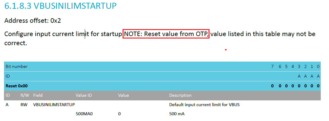

B) Both VBUSINILIM0 and VBUSINILIMSTARTUP indicate "Reset value from OTP...", does it mean there is a ONE TIME PROGRAMMABLE interface we can set so it starts from 500mA?
    As you can see from the documentation, the nPM1300 has two registers for configuring the VBUS input current limit: VBUSINILIM0 (host-configurable) and VBUSINILIMSTARTUP (startup default).
    There is also the note that you mentioned: "Reset value from OTP, value listed in this table may not be correct." which means that the startup current limit is determined by a value stored in One-Time Programmable (OTP) memory, which is set during device programming at the factory and cannot be changed by the user after production.
    The default current limit is 100 mA, and host software can update the limit after startup by writing to VBUSINILIM0 and triggering the change with TASK.UPDATE.ILIMSW. But I don't think it's possible for users to change the default (startup) current limit to 500 mA in the field or via software alone. The only way to have a different startup value would be if the device was programmed with a different OTP value at the factory, but this is not a user-accessible feature. Also, I don't think it's possible for end users or customers to program or re-program this OTP memory themselves.

  • KN7702 said:
    I speculate as such that OTP isn't something can be configured by the end-user but would like to confirm it.
    That's right. There is no way to access OTP for customers, so this default value cannot be changed.
