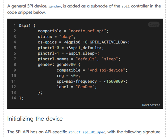

    Thank you for sharing the detailed build logs. While checking the logs, I noticed that the issue might be that the SPI device node is missing in the device tree macro. I believe you can configure the SPI device using the macro.
    struct spi_dt_spec spiSpec = SPI_DT_SPEC_GET(DT_NODELABEL(st25r3911b), SPIOP, 0);
    In your device tree, make sure to add a label, as DT_NODELABEL() works only with a label.
    st25r3911b: st25r3911b@0 {
        compatible = "st,st25r3911b";
    Check this device tree reference section.

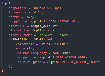

    I am able to get the project to compile when updating my devicetree overlay. The key factor was adding the label "st25r3911b:" before "st25r3911b@0" as you mentioned. For what I have seen, the examples for the nRF52833 don't have this label. Here is my device tree setup for anyone with the same problem.

    I tested the solution and found the SPI bus is functioning, so thanks for your help and I will mark your solution as the answer.
    Continuing our conversation, I am using CONFIG_SPI and CONFIG_SPI_NRFX if this is what you are referring to. When looking at the linked SPI driver, it paths to C:/ncs/v2.9.1/zephyr/include/zephyr/drivers/spi.h which I believe is the default SPI driver, right?
    I performed a search through the C:/ncs/v2.9.1 directory and found that in every overlay with "st25r3911b," the device has these two fields. Is there a sample/implementation without these fields?
