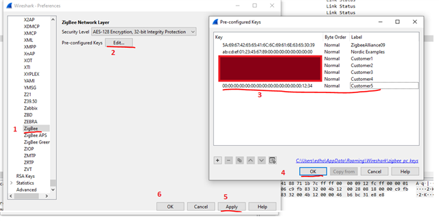

I am using an nRF52840 USB dongle to sniff some Zigbee packets for a product I am developing. I am trying to use Wireshark to decode the messages shared.  I followed the steps specified here by the Nordic Semiconductor docs. However, since I am developing the product using an MCU from another vendor utilizing ZBOSS software, the only key I could configure in the software is the "NWK key" which is 0x00000000000000000000000000001234
Following the steps specified in the steps provided by Nordic, 2 keys are used, which are ZigbeeAlliance09 and NordicExamples set to some values, 5A:69:67:42:65:65:41:6C:6C:69:61:6E:63:65:30:39 and ab:cd:ef:01:23:45:67:89:00:00:00:00:00:00:00:00, but I can't understand what these numbers mean and how to modify them to get them to sniff my product packets.

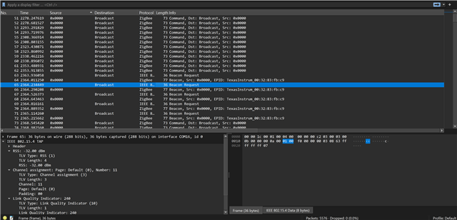

I used the values as they were and tried to sniff packets from 2 Zigbee devices (one is a coordinator and another is an end device). And here is what I got in Wireshark:
I don't understand if this is correct sniffing or not since it's my first time dealing with zibee.
