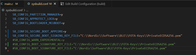

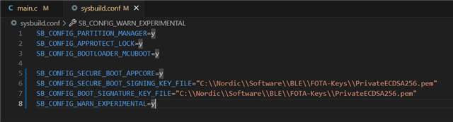

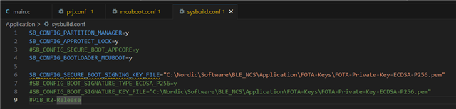

I want to add my custom-generated key for FOTA security. followed "Dev academy tutorial" as well as this page: https://docs.nordicsemi.com/bundle/ncs-3.0.0/page/nrf/app_dev/bootloaders_dfu/mcuboot_nsib/bootloader_adding_sysbuild.html
I followed this link, OPENSS,L to generate the custom key as mentioned : https://docs.nordicsemi.com/bundle/ncs-2.9.0/page/nrf/app_dev/bootloaders_dfu/mcuboot_nsib/bootloader_signature_keys.html
But I'm getting this issue on the terminal while compiling, and my custom keys seem to be getting rejected.
My objective:
1) Would like to use an Upgradable Bootloader, but when I enabled the sysbuild configs, I'm just getting errors (refer screen shoot - hence I've only attached the fully compiling configuration & it's logs here in this thread)
2) I would like to implement the custom private key solution.
My Issues:
1)  secure_boot = n (warning on terminal) -( MCUBoot bootloader key file: C:/ncs/v3.0.1/bootloader/mcuboot/root-rsa-2048.pem

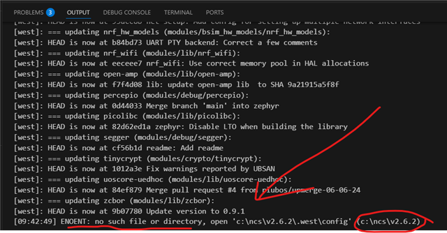

4) When I run west update (technically I'm not using the wested workspace though) on ncsv3.0.1, I'm getting issues on old SDK v2.6.2, not found error on the terminal. (see screenshot attached.)
    CMake Warning at CMakeLists.txt:393 (message):
    WARNING: Using default MCUboot signing key file, this file is for debug use
    only and is not secure!)
    How do you add the configuration for the custom key?
    What install method have you used for the nRF connect SDK?

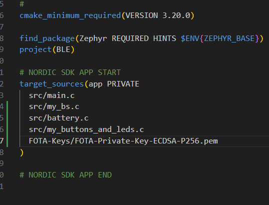

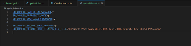

    My sample is based on the LBS sample under NCS 2.6.2. Just to be sure, I did this: (for the moment, let's forget my custom project)
    My new try is as follows:
    1) Under the new folder, I copied the sample LBS sample ncsv3.0.1
    2) Just added FOTA support based on DEVacademy tutorial & compiled it, it works on 52dk (As default key)
    3) An error occurs when I just added my custom FOTA key. Unable to build.

  • hello,
    yes i'm using Full path only in sysbuild.conf
    like this
    SB_CONFIG_SECURE_BOOT_APPCORE=y
    SB_CONFIG_SECURE_BOOT_SIGNING_KEY_FILE="C:\Nordic\Software\BLE\FOTA-Keys\FOTA-Private-Key-ECDSA-P256.pem"
    so try to use a smaller key name.
    Tried this as well but no effect!
    Also added this under cmakelist.txt (example on my original project.)
  • Ah I thought this was the key for MCUboot, and not for NSIB.
    I see now that it is for NSIb.
    In this case, can you try to set the MCUboot key instead: SB_CONFIG_BOOT_SIGNATURE_KEY_FILE.
    Does this fail as well?
    This is a good test to see if it is a CMake can not find the file, or if the issue is specific to the NSIB option.
  • Hello
    yes this fails as well. tried it on both my personal project & the 52DK LBS project as well.

  • Try to escape all the "\"s:
    "C:\\Nordic\\Software\\BLE\\FOTA-Keys\\FOTA-Private-Key-ECDSA-P256.pem"
    No success ...here is the logs

    But a new development:
    I've did it like this....
    Its log is this:
     *  Executing task: nRF Connect: Generate config p1br2/nrf52832 for c:\Nordic\Software\BLE
