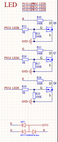

nRF52832-QFAA using the LDO power supply mode,The firmware is configured to operate in the LDO power supply mode.The compilation and download processes are all fine.but the blinky test example,After the reset operation, the LED showed no reaction at all.The LED driving circuit is functioning properly.
What should I do?

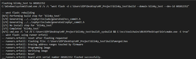

vs code flash log:

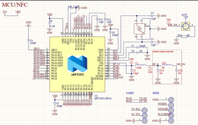

hardware design:power LDO mode

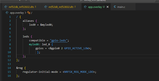

blinky test  example:
