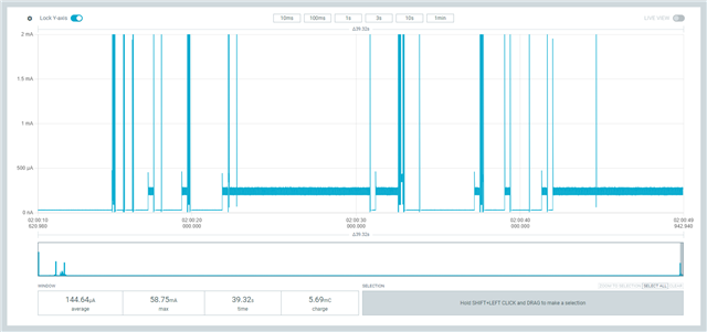

I run the system_off example without the system actually going off, by removing all the calls to start the system_off worker. Instead of going to off, I let the system enter sleep mode (k_sleep()).
I enabled wake up on nfc.
After a reset, the system enters sleep (4-5uA sleep current). After waking the system by nfc, the sleep current sometimes becomes 200uA, sometimes stays at 4uA. See picture below.
It seems to be related to the state of the nfc peripheral as this is the only peripheral used.
Any idea how to prevent the system going to sleep with a 200uA sleep current?

    Have you tried enabled logging to see if there's any difference of what happens in the app when you see the difference between when the 200µA and 4-5µA.

    I did debug the app and checked if there was a difference in NFC registers values, and there was. So it might be that the NFC peripheral is in a state that draws more power. But the NFC library should take care of this. I tried to re-start the NFC by calling nfc_t4t_done() and nfc_t4t_setup() before k_sleep(). Didn't help.

    Where does the application go to sleep exactly? Since you've figured out it is the NFC register values doing this it might be that the application goes into a sleep mode before the nfc_t4t_done() function is done uninitializing the NFC peripheral so it is still running when in sleep. You could try adding a wait/check to make sure that the nfc_t4t_done() is completed before the k_sleep is called.

    I expect to see a very low current, but sometimes see the 200uA when woken up by the nfc peripheral (or otherwise, did not test that)
