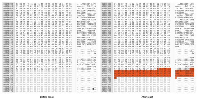

New data is added to the settings partition after every reboot.
Hello
I'm using the settings partition to store user configuration data. I know that the BLE stack also uses it — particularly for storing bonding information — but I don't understand why new data keeps getting stored in the settings automatically after each reset (see the orange-highlighted section).
Among these data, I noticed the Bluetooth name (FREEDOM) and the extended advertised name (FREEDOM EXTENDED).
Why do these keys keep appearing after every reset?

    Normally, device name is not written to settings. However, if you have CONFIG_BT_DEVICE_NAME_DYNAMIC=y and call bt_set_name() it is written. Is that what is happening here? This is also described in this post.
  • Is it possible to avoid calling bt_set_name() to prevent the Bluetooth name from being stored again in the settings partition?

    Do you requier a dynamic name? If not, you would be better of disabling it and setting the name build time as is done in most Bluetooth samples. If you need a dynamic name, I would check the existing name using bt_get_name() and verify if it needs to be updated, before you call bt_set_name(). That way there is only a write when you actually need to update the name.
