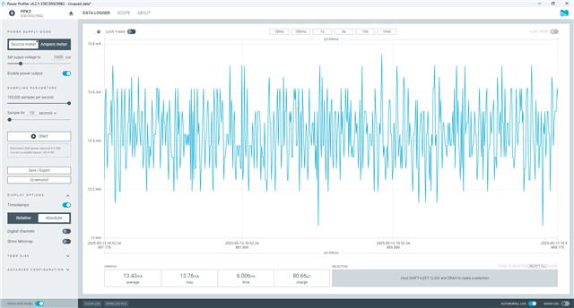

I tried to look into this today but when selecting Absolute Timestamps, it is showing absolute timestamps in the tool but when I export the data to .csv to combine the data outside the app as suggested, it only has relative timestamps. Is this a bug?
Perhaps the starting absolute time could be captured in the exported file name but that file name is associated to the time at which the export is made rather than the start or end time of the capture and also only has the time up to seconds rather than 10us resolution (aligning with the chosen 100k sample rate).

our developers inform me that the absolute time stamp is not exported to the .csv, but they have taken note and added a feature request for this. They state:
The absolute time in only in the
metadata.jsonand is in https://github.com/NordicSemiconductor/pc-nrfconnect-ppk/blob/f60119b807f0c83c33ce9dcb2e10600ebc59c486/src/utils/saveFileHandler.ts#L32 -> `startSystemTime`
Let me know how that works for you
