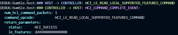

is hci_uart sample support le audio/auracast?
I am using bumble(github.com/.../bumble) as host and nrf 5340 audio DK as controller. I use  python auracast.py scan serial:/dev/ttyACM0,115200, and this error appears:
Periodic advertising not supported. Later, I added CONFIG_BT_EXT_ADV=y
CONFIG_BT_PER_ADV_SYNC=y to prj.conf, but still got the same error.

  • I added the two configurations you mentioned, but still got the same error. The HCI log showed that the controller replied that it did not support Periodic advertising.
    DEBUG:bumble.host:### HOST -> CONTROLLER: HCI_LE_READ_LOCAL_SUPPORTED_FEATURES_COMMAND
    DEBUG:bumble.host:### CONTROLLER -> HOST: HCI_COMMAND_COMPLETE_EVENT:
      num_hci_command_packets: 1
      command_opcode:          HCI_LE_READ_LOCAL_SUPPORTED_FEATURES_COMMAND
      return_parameters:
        status:      HCI_SUCCESS
        le_features: dd49000000000000
    BUMBLE_LOGLEVEL=DEBUG python auracast.py scan serial:/dev/ttyACM0,115200
    Then I changed the system build option of hci_uart to sysbuild, and there was no error when running the program after burning.
