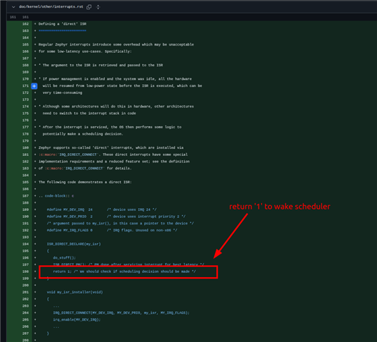

I'm using an nrfx_timer event with k_poll_signal_raise to trigger a thread to perform an operation.
I've noticed around 900ms delay between when the signal is raised and the k_poll runs in the thread.
This is observed using a logic analyzer with logging level error.
I cannot explain where this delay is coming from. I used systemview tracing and also used the user tracer with my own traveller to find out what is running during this time and it only shows system idle task running.
I'm out of ideas and wanted to see if you've encountered anything similar? Here's the code snippet of what I'm trying to do:

  • Excellent! Yes, the regular Zephyr ISR will automatically trigger the PendSV exception on exit to wake up the scheduler and check for pending tasks. If PendSV is not triggered, program execution will just return to where it was prior to the interrupt (the idle thread in your case). It is possible to do the same with 'direct' interrupts, but then you must declare your own ISR as mentioned in the linked commit.
