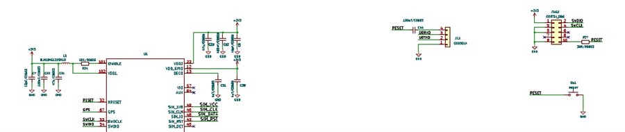

J-Link DLL (error code =-1) programming custom nRF9160 board
I am trying to program the custom nRF9160 board using SEGGER JLink/SWD programmer, For same of the boards when connected to custom board and trying to select the device in the programmer tool in nRF Connect for Desktop I get the following error.

i try to program with VScode: nrfjprog --log --program 'd:\ncs\app\acc_nrf9160\build\zephyr\merged.hex' --sectorerase --verify -f NRF91 --snr 52005496
and i get this errors:

What could be the problem? it is anything i can do to recover this boards?
(I can program most boards without problems but some I can't)
  • Can you measure VDD_GPIO to confirm that it's the right voltage? Also. if you haven't tried it you can run nrfjprog --recover.
  • VDD_GPIO is 3.38V

  • How many of the boards are affected by this? What is the current draw on the boards?
  • Hi, thanks for sharing this issue. Just to clarify:
    • Have you confirmed that the custom nRF9160 board has the correct pin connections for SWD (SWDIO/SWCLK/GND/RESET)?
    • Is the J-Link detected properly via nrfjprog --version?
    • Sometimes error code -1 is due to power supply issues—can you confirm that the board is powered correctly and detectable via J-Link Commander?
    • Also, which version of the J-Link software and nRF Command Line Tools are you using?
    Speed Stars Game
    Let me know if you’ve tried erasing the chip using nrfjprog --eraseall before flashing.
    Hope this helps!
  • So far we have 30 boards affected from 2500 (~1%). The current draw from affected board is 21mA, for working board is 23mA before programing and 4.6mA after. We power the board with 6.4V source.
