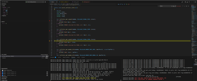

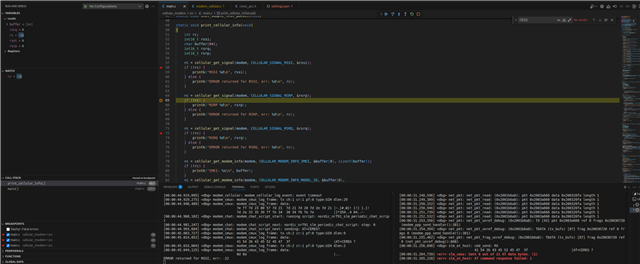

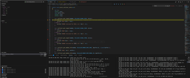

Possible Bug: Cellular modem sample with nRF9151 running SLM
I posted this in Zephyr's repo at first, but was told to post it here since I am using NCS.
I am running cellular modem sample on nRF54L15 and have it interfaced with nRF9151 which is running SLM application.
Everything is working except cellular_get_signal(), I am not using 2G or 3G so it is expected that CELLULAR_SIGNAL_RSSI might not be available, however the calls to that function with CELLULAR_SIGNAL_RSRQ and CELLULAR_SIGNAL_RSRP fail also.
They return either -16 (EBUSY) or -22(EINVAL) error codes (it is not consistent).
Calls to cellular_get_modem_info() are successful and they return correct information.
These are the debug logs including modem_chat, interestingly looking at the logs, I actually receive the correct values for RSRQ and RSRP -> 23 61, however the get_signal_cesq_chat_script times out.
[00:01:01.773,996] <dbg> modem_chat: modem_chat_script_next: sending: AT+CESQ
[00:01:01.774,038] <dbg> modem_cmux: modem_cmux_log_frame: tx ch:2 cr:1 pf:0 type:UIH dlen:7
[00:01:01.774,052] <dbg> modem_cmux: modem_cmux_log_frame: data:
                                     41 54 2b 43 45 53 51                             |AT+CESQ
[00:01:01.774,089] <dbg> modem_cmux: modem_cmux_log_frame: tx ch:2 cr:1 pf:0 type:UIH dlen:2
[00:01:01.774,102] <dbg> modem_cmux: modem_cmux_log_frame: data:
                                     0d 0a                                            |..
[00:01:01.814,943] <dbg> modem_cmux: modem_cmux_log_frame: rcvd ch:2 cr:1 pf:0 type:UIH dlen:31
[00:01:01.814,959] <dbg> modem_cmux: modem_cmux_log_frame: data:
                                     0d 0a 2b 43 45 53 51 3a  20 39 39 2c 39 39 2c 32 |..+CESQ:  99,99,2
                                     35 35 2c 32 35 35 2c 32  33 2c 36 31 0d 0a 0d    |55,255,2 3,61...
[00:01:01.815,049] <dbg> modem_chat: modem_chat_log_received_command: +CESQ:  99 99 255 255 23 61
[00:01:01.815,080] <dbg> modem_chat: modem_chat_script_next: get_signal_cesq_chat_script: step: 1
[00:01:03.319,140] <dbg> modem_cellular: modem_cellular_log_event: event timeout
[00:01:03.774,060] <wrn> modem_chat: get_signal_cesq_chat_script: timed out
P.S. I only added couple of new lines in print_cellular_info() function to try to fetch RSRP and RSRQ

    Retrieving cellular info
    [00:00:29.371,397] <dbg> modem_chat: modem_chat_script_start: running script: get_signal_csq_chat_script
    [00:00:29.383,572] <dbg> modem_chat: modem_chat_script_next: get_signal_csq_chat_script: step: 0
    [00:00:29.395,042] <dbg> modem_chat: modem_chat_script_next: sending: AT+CSQ
    [00:00:29.404,783] <dbg> modem_cmux: modem_cmux_log_frame: tx ch:2 cr:1 pf:0 type:UIH dlen:6
    [00:00:29.415,908] <dbg> modem_cmux: modem_cmux_log_frame: data:
                                         41 54 2b 43 53 51                                |AT+CSQ
    [00:00:29.434,035] <dbg> modem_cmux: modem_cmux_log_frame: tx ch:2 cr:1 pf:0 type:UIH dlen:2
    [00:00:29.445,153] <dbg> modem_cmux: modem_cmux_log_frame: data:
                                         0d 0a                                            |..
    [00:00:29.499,889] <dbg> modem_cmux: modem_cmux_log_frame: rcvd ch:2 cr:1 pf:0 type:UIH dlen:21
    [00:00:29.511,284] <dbg> modem_cmux: modem_cmux_log_frame: data:
                                         0d 0a 2b 43 53 51 3a 20  39 39 2c 39 39 0d 0a 0d |..+CSQ:  99,99...
                                         0a 4f 4b 0d 0a                                   |.OK..
    [00:00:29.538,914] <dbg> modem_chat: modem_chat_log_received_command: +CSQ:  99 99
    [00:00:29.549,164] <dbg> modem_chat: modem_chat_script_next: get_signal_csq_chat_script: step: 1
    [00:00:29.560,651] <dbg> modem_chat: modem_chat_log_received_command: OK
    [00:00:29.570,012] <dbg> modem_chat: modem_chat_script_stop: get_signal_csq_chat_script: complete
    [00:00:29.581,603] <dbg> modem_cellular: modem_cellular_log_event: event script success
    [00:00:29.592,321] <dbg> modem_chat: modem_chat_script_start: running script: get_signal_cesq_chat_script
    [00:00:29.604,594] <dbg> modem_chat: modem_chat_script_next: get_signal_cesq_chat_script: step: 0
    [00:00:29.616,156] <dbg> modem_chat: modem_chat_script_next: sending: AT+CESQ
    [00:00:29.625,984] <dbg> modem_cmux: modem_cmux_log_frame: tx ch:2 cr:1 pf:0 type:UIH dlen:7
    [00:00:29.637,113] <dbg> modem_cmux: modem_cmux_log_frame: data:
    [00:00:29.655,249] <dbg> modem_cmux: modem_cmux_log_frame: tx ch:2 cr:1 pf:0 type:UIH dlen:2
    [00:00:29.666,371] <dbg> modem_cmux: modem_cmux_log_frame: data:
                                         0d 0a                                            |..
    [00:00:29.725,314] <dbg> modem_cmux: modem_cmux_log_frame: rcvd ch:2 cr:1 pf:0 type:UIH dlen:31
    [00:00:29.736,715] <dbg> modem_cmux: modem_cmux_log_frame: data:
                                         35 35 2c 32 35 35 2c 32  33 2c 36 30 0d 0a 0d    |55,255,2 3,60...
    [00:00:29.764,401] <dbg> modem_chat: modem_chat_log_received_command: +CESQ:  99 99 255 255 23 60
    [00:00:29.775,968] <dbg> modem_chat: modem_chat_script_next: get_signal_cesq_chat_script: step: 1
    [00:00:30.357,130] <dbg> modem_cmux: modem_cmux_log_frame: tx ch:1 cr:1 pf:0 type:UIH dlen:29
    [00:00:30.368,357] <dbg> modem_cmux: modem_cmux_log_frame: data:
                                         7e ff 7d 23 80 57 7d 21  7d 21 7d 20 7d 2e 7d 21 |~.}#.W}! }!} }.}!
                                         7d 2a 33 35 39 ff fe 34  30 34 f6 fe 7e          |}*359..4 04..~
    [00:00:30.433,151] <dbg> modem_cmux: modem_cmux_log_frame: rcvd ch:1 cr:1 pf:0 type:UIH dlen:31
    [00:00:30.444,552] <dbg> modem_cmux: modem_cmux_log_frame: data:
                                         7e ff 7d 23 c0 21 7d 28  7d 21 7d 20 7d 32 80 57 |~.}#.!}( }!} }2.W
                                         7d 21 7d 21 7d 20 7d 2e  7d 21 7d 2a 33 35 39    |}!}!} }. }!}*359
    [00:00:30.472,182] <dbg> modem_cmux: modem_cmux_log_frame: rcvd ch:1 cr:1 pf:0 type:UIH dlen:6
    [00:00:30.483,486] <dbg> modem_cmux: modem_cmux_log_frame: data:
                                         ff fe 34 9c fc 7e                                |..4..~
    [00:00:30.501,641] <dbg> modem_ppp: modem_ppp_process_received_byte: Receiving PPP frame
    [00:00:30.512,488] <dbg> modem_ppp: modem_ppp_process_received_byte: Received PPP frame (len 22)
    [00:00:30.524,199] <dbg> modem_cmux: modem_cmux_log_frame: tx ch:1 cr:1 pf:0 type:UIH dlen:43
    [00:00:30.535,421] <dbg> modem_cmux: modem_cmux_log_frame: data:
                                         7e ff 7d 23 c0 21 7d 27  7d 21 7d 20 7d 34 c0 21 |~.}#.!}' }!} }4.!
                                         7d 28 7d 21 7d 20 7d 32  80 57 7d 21 7d 21 7d 20 |}(}!} }2 .W}!}!}
                                         7d 2e 7d 21 7d 2a 33 35  93 66 7e                |}.}!}*35 .f~
    [00:00:30.572,560] <dbg> modem_cmux: modem_cmux_log_frame: tx ch:1 cr:1 pf:0 type:UIH dlen:12
    [00:00:30.583,780] <dbg> modem_cmux: modem_cmux_log_frame: data:
                                         20 7d 2e 7d 21 7d 2a 33  35 93 66 7e             | }.}!}*3 5.f~
    [00:00:30.893,819] <dbg> modem_cellular: modem_cellular_log_event: event timeout
    [00:00:31.626,000] <wrn> modem_chat: get_signal_cesq_chat_script: timed out
    [00:00:31.635,917] <dbg> modem_cellular: modem_cellular_log_event: event script failed
    [00:00:31.646,539] <dbg> modem_chat: modem_chat_script_start: running script: get_signal_cesq_chat_script
    [00:00:31.658,811] <dbg> modem_chat: modem_chat_script_next: get_signal_cesq_chat_script: step: 0
    [00:00:31.670,371] <dbg> modem_chat: modem_chat_script_next: sending: AT+CESQ
    [00:00:31.680,200] <dbg> modem_cmux: modem_cmux_log_frame: tx ch:2 cr:1 pf:0 type:UIH dlen:7
    [00:00:31.691,326] <dbg> modem_cmux: modem_cmux_log_frame: data:
    [00:00:31.709,463] <dbg> modem_cmux: modem_cmux_log_frame: tx ch:2 cr:1 pf:0 type:UIH dlen:2
    [00:00:31.720,588] <dbg> modem_cmux: modem_cmux_log_frame: data:
                                         0d 0a                                            |..
    [00:00:31.779,531] <dbg> modem_cmux: modem_cmux_log_frame: rcvd ch:2 cr:1 pf:0 type:UIH dlen:31
    [00:00:31.790,930] <dbg> modem_cmux: modem_cmux_log_frame: data:
                                         35 35 2c 32 35 35 2c 32  34 2c 36 30 0d 0a 0d    |55,255,2 4,60...
    [00:00:31.818,576] <dbg> modem_chat: modem_chat_on_unknown_command_received:
    [00:00:31.828,525] <dbg> modem_chat: modem_chat_log_received_command: +CESQ:  99 99 255 255 24 60
    [00:00:31.840,092] <dbg> modem_chat: modem_chat_script_next: get_signal_cesq_chat_script: step: 1
    [00:00:33.357,258] <dbg> modem_cmux: modem_cmux_log_frame: tx ch:1 cr:1 pf:0 type:UIH dlen:29
    [00:00:33.368,488] <dbg> modem_cmux: modem_cmux_log_frame: data:
    [00:00:33.433,410] <dbg> modem_cmux: modem_cmux_log_frame: rcvd ch:1 cr:1 pf:0 type:UIH dlen:31
    [00:00:33.444,815] <dbg> modem_cmux: modem_cmux_log_frame: data:
    [00:00:33.472,457] <dbg> modem_cmux: modem_cmux_log_frame: rcvd ch:1 cr:1 pf:0 type:UIH dlen:6
    [00:00:33.483,768] <dbg> modem_cmux: modem_cmux_log_frame: data:
    [00:00:33.501,931] <dbg> modem_ppp: modem_ppp_process_received_byte: Receiving PPP frame
    [00:00:33.512,777] <dbg> modem_ppp: modem_ppp_process_received_byte: Received PPP frame (len 22)
    [00:00:33.524,491] <dbg> modem_cmux: modem_cmux_log_frame: tx ch:1 cr:1 pf:0 type:UIH dlen:43
    [00:00:33.535,720] <dbg> modem_cmux: modem_cmux_log_frame: data:
    [00:00:33.572,878] <dbg> modem_cmux: modem_cmux_log_frame: tx ch:1 cr:1 pf:0 type:UIH dlen:12
    [00:00:33.584,101] <dbg> modem_cmux: modem_cmux_log_frame: data:
    [00:00:33.646,588] <dbg> modem_cellular: modem_cellular_log_event: event timeout
    [00:00:33.680,240] <wrn> modem_chat: get_signal_cesq_chat_script: timed out
    [00:00:33.690,153] <dbg> modem_cellular: modem_cellular_log_event: event script failed

    Please find the screenshots from debugging session in VScode.
    RSSI Error:
    RSSI error
    RSRP Error:
    RSRP error
    RSRQ error:
    RSRQ error
  • I would like to provide an update, which seems to give chance to the application to fetch the values from time to time.
