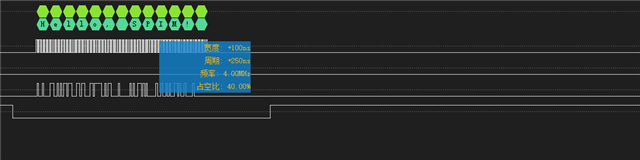

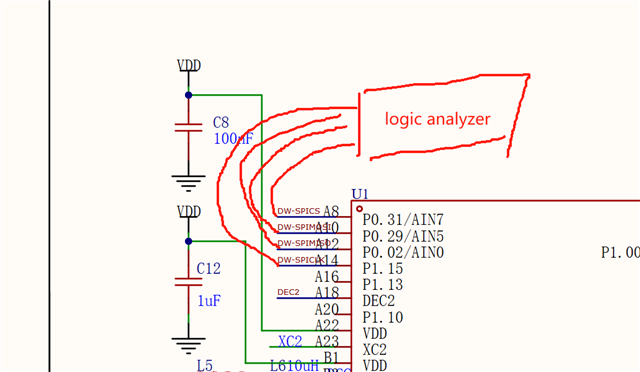

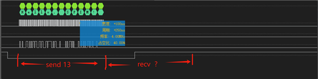

I used SPIM2 to send the string "Hello, SPIM!" and receive data of the same length.
However, on the logic analyzer, I can only see the transmitted signals, and there are no received signals。

I think that even if the slave doesn't respond, the master should still generate 13 bytes worth of clock signals.
