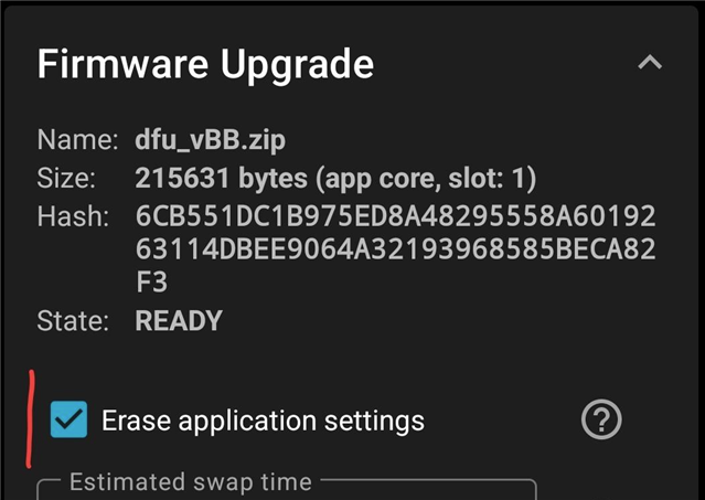

Issue 1: settings_storage is erased after BLE DFU
We are using BLE DFU and the settings subsystem to persist device parameters.
Everything works fine under normal conditions, but after performing DFU, the parameters are lost.
Example memory dump before DFU:

After DFU:

We expected settings_storage to be preserved, as it is located outside the mcuboot_primary and mcuboot_secondary partitions.

This indicates that settings_storage is located at 0x15f000, well outside the regions that DFU should be erasing.
Yet after DFU, the memory content of settings_storage appears wiped.
Questions:
  • Could the BLE DFU process be erasing more flash than intended?
  • Is there any MCUboot or Zephyr behavior we might be missing regarding retention of NVS/Settings partitions during DFU?

    If you are using the Android version of "nrf connect," there is the options : settings->Mcu Manager options->Erase application setting
    For iOS, see this post
