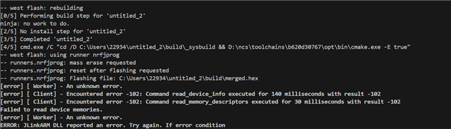

Flashing Failure on nRF52832 via VSCode and J-Link Reset Pin Issue
Dear Nordic Support Team,​
I am experiencing difficulties flashing firmware to my ​​nRF52832​​ development board using ​​VSCode​​ with west flash, followed by J-Link connectivity issues. The problem seems hardware-related, and I would appreciate your expertise to resolve it.
​Issue Summary​
  1. ​VSCode Flashing Error (Image 1):​
    • Command: west flash with nrfjprog runner (mass erase enabled).
    • Error sequence:
      • Error -102 during "read device info" and "read memory_descriptors".
      • Final error: JlinkARM DLL reported an error.

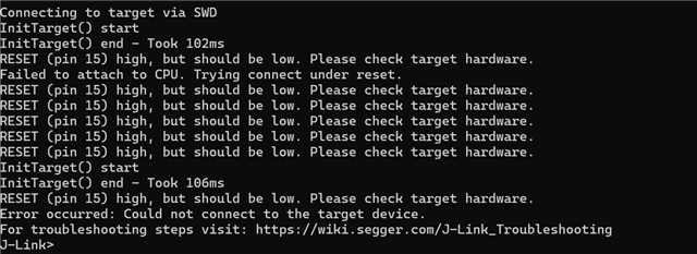

  2. ​J-Link Commander Diagnosis (Image 2):​
    • Connection via ​​SWD​​ repeatedly fails with:
      • RESET (pin 15) high, but should be low. Please check target hardware.
    • Attempts to "connect under reset" yield the same result.

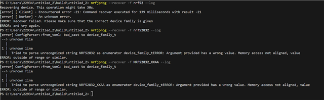

    Could you try to run "nrfjprog --recover -f nrf52 --log"? and if it fails, please upload the .log file here.
    If it still fails, try this batch script:
     RE: Unable to Recover nRF52832 After Debugging Session
    Håkon
  • you mean in this way?
    [2025-May-09 20:19:34] [debug] --------------------------------------------------------------------------------
    [2025-May-09 20:19:34] [debug] D:\nrf commmand line\bin\nrfjprog.exe --recover -f nrf52 --log
    [2025-May-09 20:19:34] [debug] nrfjprog version 10.24.2 external

    [2025-May-09 20:19:35] [debug] [SeggerBackend] - Attempting to clear any configuration errors in debug port before closing connection.
    [2025-May-09 20:19:35] [trace] [  JLink] - JLINK_CORESIGHT_WriteAPDPReg(DP reg 0x00, 0x0000001F)
    [2025-May-09 20:19:35] [trace] [  JLink] - - 0.623ms returns -1
    [2025-May-09 20:19:35] [trace] [  JLink] - JLINK_HasError()
    [2025-May-09 20:19:35] [trace] [  JLink] - - 0.614ms returns -1
    [2025-May-09 20:19:35] [trace] [  JLink] - - 0.558ms returns -1
    [2025-May-09 20:19:35] [trace] [  JLink] - - 0.598ms returns -1
    [2025-May-09 20:19:35] [trace] [  JLink] - - 0.632ms returns -1
    [2025-May-09 20:19:35] [trace] [  JLink] - - 0.637ms returns -1
    [2025-May-09 20:19:35] [trace] [  JLink] - JLINK_CORESIGHT_WriteAPDPReg(DP reg 0x02, 0x00000000)
    [2025-May-09 20:19:35] [trace] [  JLink] - - 0.702ms returns -1
    [2025-May-09 20:19:35] [debug] [SeggerBackend] - ---just_abort_debug_action
    [2025-May-09 20:19:35] [trace] [  JLink] - - 0.493ms returns -1
    [2025-May-09 20:19:35] [trace] [  JLink] - - 0.509ms returns -1
    [2025-May-09 20:19:35] [trace] [  JLink] - - 0.657ms returns -1
    [2025-May-09 20:19:35] [trace] [  JLink] - - 0.468ms returns -1
    [2025-May-09 20:19:35] [trace] [  JLink] - - 0.602ms returns -1
    [2025-May-09 20:19:35] [trace] [  JLink] - - 0.599ms returns -1
    [2025-May-09 20:19:35] [trace] [  JLink] - - 0.666ms returns -1
    [2025-May-09 20:19:35] [trace] [  JLink] - - 0.565ms returns -1
    [2025-May-09 20:19:35] [trace] [  JLink] - - 0.967ms returns -1
    [2025-May-09 20:19:35] [trace] [  JLink] - - 0.531ms returns -1
    [2025-May-09 20:19:35] [trace] [  JLink] - - 0.543ms returns -1
    [2025-May-09 20:19:35] [trace] [  JLink] - - 0.525ms returns -1
    [2025-May-09 20:19:35] [trace] [  JLink] - - 0.504ms returns -1
    [2025-May-09 20:19:35] [trace] [  JLink] - - 0.489ms returns -1
    [2025-May-09 20:19:35] [trace] [  JLink] - - 0.609ms returns -1
    [2025-May-09 20:19:35] [trace] [  JLink] - - 0.613ms returns -1
    [2025-May-09 20:19:35] [trace] [  JLink] - - 0.608ms returns -1
    [2025-May-09 20:19:35] [trace] [  JLink] - - 0.529ms returns -1
    [2025-May-09 20:19:35] [trace] [  JLink] - - 0.548ms returns -1
    [2025-May-09 20:19:35] [trace] [  JLink] - - 0.563ms returns -1
    [2025-May-09 20:19:35] [trace] [  JLink] - - 0.480ms returns -1
    [2025-May-09 20:19:35] [trace] [  JLink] - - 0.522ms returns -1
    [2025-May-09 20:19:35] [trace] [  JLink] - - 0.492ms returns -1
    [2025-May-09 20:19:35] [trace] [  JLink] - - 0.499ms returns -1
    [2025-May-09 20:19:35] [trace] [  JLink] - - 0.470ms returns -1
    [2025-May-09 20:19:35] [debug] [SeggerBackend] - Ignore exception An unknown error.
    [2025-May-09 20:19:35] [trace] [  JLink] - - 0.038ms
    [2025-May-09 20:19:35] [trace] [  JLink] - JLINK_Close()
    [2025-May-09 20:19:35] [debug] [SeggerBackend] - Segger Backend closed.
    [2025-May-09 20:19:35] [debug] [  nRF52] - nRF family DLL closed
    [2025-May-09 20:19:35] [trace] [ Client] - Command close executed for 77 milliseconds with result 0
    [2025-May-09 20:19:35] [debug] [ Client] - terminate
    [2025-May-09 20:19:35] [trace] [ Worker] - Command close executed for 61 milliseconds with result 0
    [2025-May-09 20:19:35] [trace] [ Client] - Command terminate executed for 0 milliseconds with result 0
    [2025-May-09 20:19:35] [trace] [ Worker] - Command terminate executed for 0 milliseconds with result 0
    [2025-May-09 20:19:35] [trace] [ Worker] - Executed 8 commands for 335 milliseconds
    [2025-May-09 20:19:35] [debug] [ Client] - Worker process exited with code: 0
    [2025-May-09 20:19:35] [debug] [ Client] - Child process terminated with result 0
    [2025-May-09 20:19:35] [trace] [ Client] - Executed 8 commands for 434 milliseconds
    [2025-May-09 20:19:47] [debug] --------------------------------------------------------------------------------
    [2025-May-09 20:19:47] [debug] D:\nrf commmand line\bin\nrfjprog.exe --recover -f nrf52832 --log
    [2025-May-09 20:19:47] [debug] nrfjprog version 10.24.2 external
    [2025-May-09 20:19:47] [ info] Load library at D:\nrf commmand line\bin\nrfjprog.dll.
    [2025-May-09 20:19:47] [ info] Library loaded, loading member functions.
    [2025-May-09 20:19:47] [ info] Member functions succesfully loaded.
    [2025-May-09 20:21:01] [debug] --------------------------------------------------------------------------------
    [2025-May-09 20:21:01] [debug] D:\nrf commmand line\bin\nrfjprog.exe --recover -f NRF52832_XXAA --log
    [2025-May-09 20:21:01] [debug] nrfjprog version 10.24.2 external
    [2025-May-09 20:21:01] [ info] Load library at D:\nrf commmand line\bin\nrfjprog.dll.
    [2025-May-09 20:21:01] [ info] Library loaded, loading member functions.
    [2025-May-09 20:21:01] [ info] Member functions succesfully loaded.
    Have you measured current with your kit?
    Can you check if the solder bridge "SB" is cut just above the USB connector on the kit? If yes, you will need a jumper on this 2-pin current measurement header.
    Håkon
