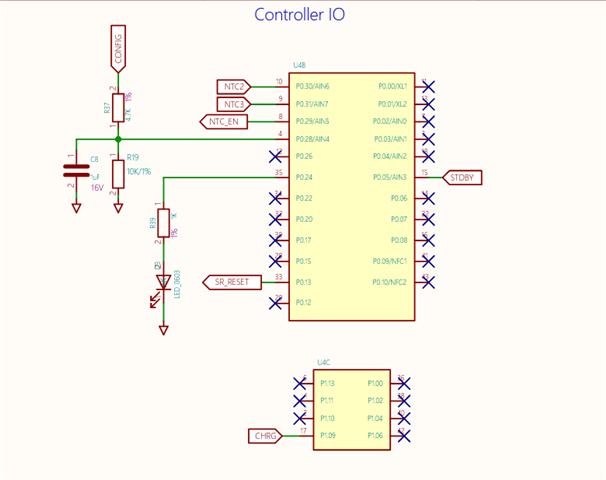

Persistent Failure in ble_stack_init() with sd_softdevice_enable (Error 8194) on nRF52840 (PCA10056, S140)
Hello Nordic community,
I’m working on a project with the nRF52840 DK (PCA10056) using the nRF5 SDK and the S140 SoftDevice.
My goal is to:
1. Read two NTC thermistors using SAADC (P0.30/AIN6 and P0.31/AIN7) every 100 ms.
2. Control an NTC enable pin (NTC_EN) on P0.29 to power the NTC circuit.
3. Toggle an LED (P0.24) every 200 ms.
4. Set a reset pin (P0.13) high after 10 seconds and stop NTC sampling.
5. Advertise via BLE
Issue:
The ble_stack_init() function consistently fails at sd_softdevice_enable(), returning error code 8194 (0x2002). I’ve confirmed the SoftDevice is flashed.
Here’s the relevant log:

  • Hi
    This seems to be due to some faulty interrupt priority settings in your application. Note that interrupt priority levels 0, 1 and 4 are restricted to the SoftDevice, so if anything else in your application uses these priority levels please set them to "correct" interrupt priorities and see if you can still see this issue?
    Simon
  • Hi Simon,
    I've reviewed the interrupt priority settings in my application, focusing on sdk_config.h for nRF5 SDK. All configured priorities for peripherals like GPIOTE and SAADC are set to safe values (e.g., 6 or 3), and none are using the restricted SoftDevice levels 0, 1, or 4.
    Could you suggest other potential causes or specific areas to debug further?
    Any additional insights would be appreciated.
    Zeel
  • I have seen this before and it was related to the lfclk configuration.
    Also, I would have a different call order for initialization just to be sure that Softdevice have its interrupt configurations unaltered.
    nrf_drv_clock_init();
    ble_stack_init();      // SDH enable + sd_ble_enable
