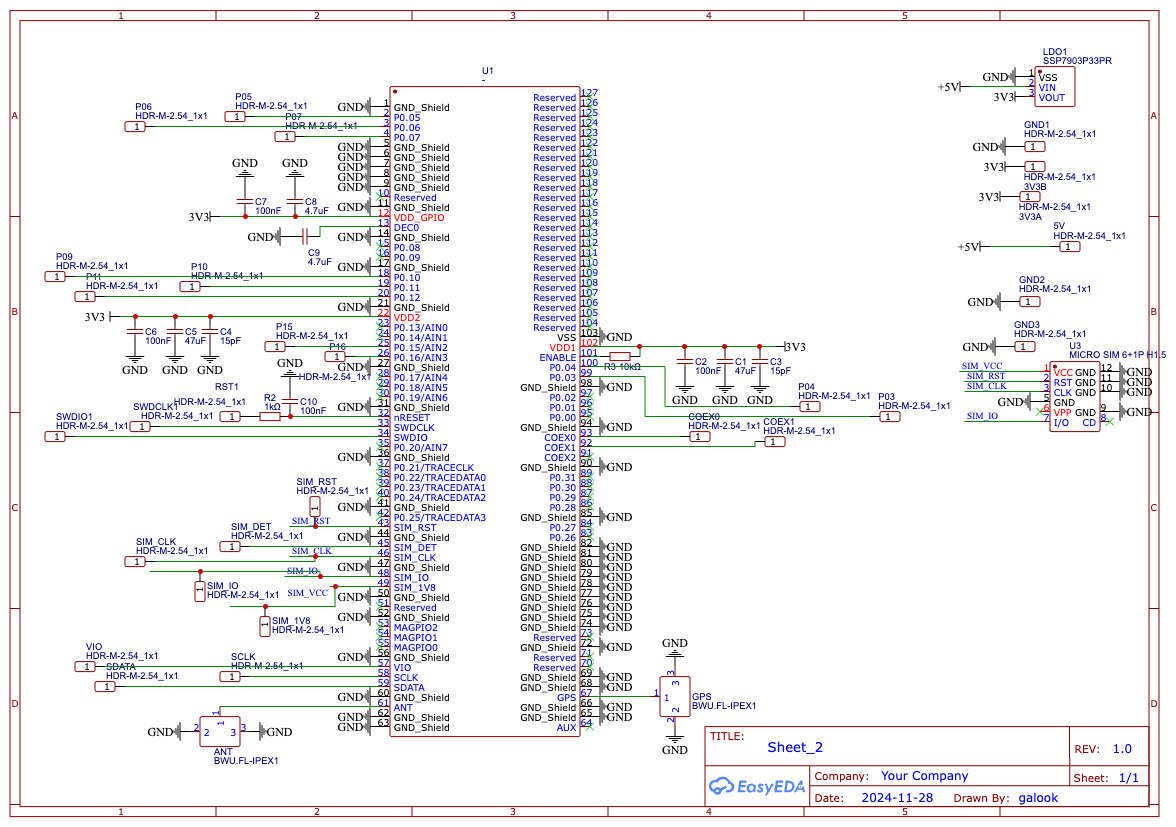

Issue programming my board with the nrf9160
I have designed this schematic according to reference designs provided by Nordic Semi, however I might have failed as I am unable to flash the main module. I should mention I am a beginner, however not a complete beginner, as I've created functioning PCBs in the past.
I am flashing it using the nrf9161DK via SWD and I am sure the connections are correct. Still, the Programmer app of Nordic SDK doesnt recognize the new board with the nrf9160
The following is the log file of "nrfjprog --eraseall --log" with the DK connected by USB to the host computer and my board connected to the DK by the P20 pins

Below is the schematic:
Thank you for your help
Matej Holubec
Parents Reply
    galook said:
    I'm using the nrf9161-DK
    My apologies for misreading! I see that you found the board configurator tool, which is great.
    galook said:
    I can't believe it, but using the board configurator I switched the VDDIO voltage to 3.3V and I have been able to start the nrf connect programmer with the custom board.
    This is great news! I am very happy to have helped out. Hope you have a wonderful day!
