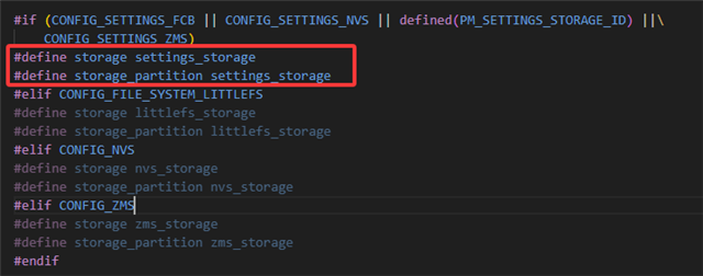

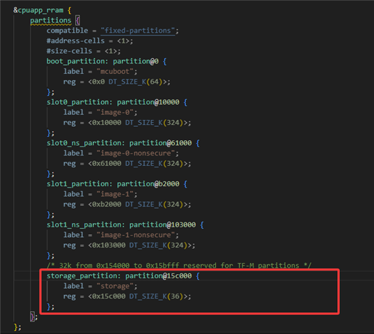

1.Is the storage_partition in the flash_map_pm.h file the same as that in the nrf54l15_cpuapp_common.dtsi file? If the same, does this mean that the size of settings_storage is 36K?  Is settings_storage the area used to store ble configuration information?
    If you use the partition manager, the DTS one is ignored, and partition manager partitioning is used instead.
    settings_storage is used for Settings, so yes.
