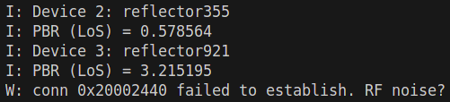

W: conn failed to establish. RF noise? (reopened ticket)
I was talking to Susheel Nuguru about the multiconnection problem that i had in my other ticket about multiconnections for Channel Sounding, which had the same title as this one.
I verified his answer and the ticket was closed it said, but my problem was actually not solved yet. I need this problem to be fixed pretty soon and i was worried that he maybe could not see my reply on his verified answer...

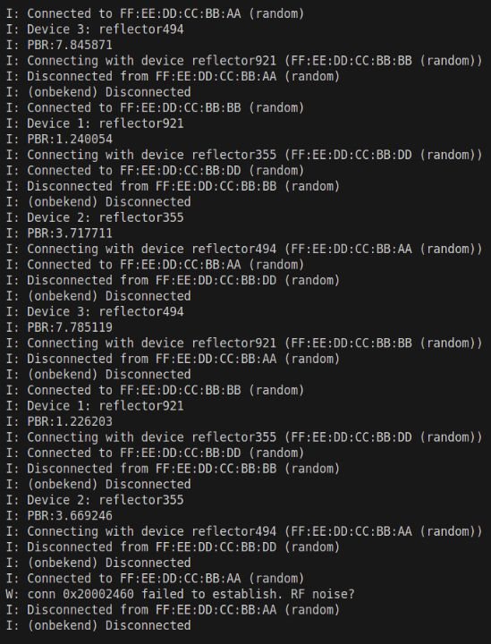

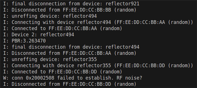

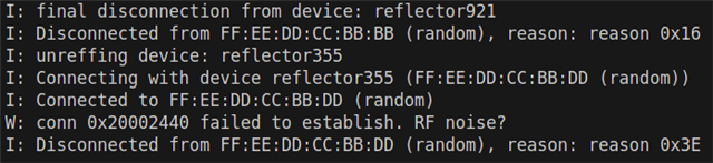

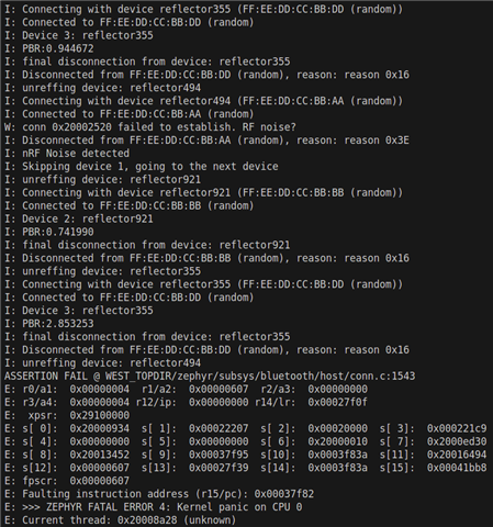

Here is my problem again:
somethimes i get this Warning when connecting with devices without getting any errors (which stops my code) and this happens at this moment in my main code:

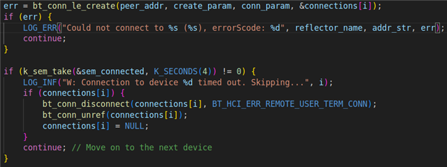

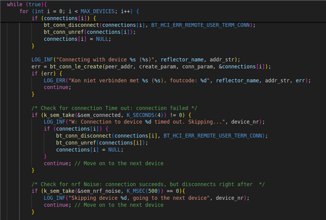

I followed the suggestion to give a semaphore also when a connection fails (in connected_cb() ) to get in this SKIP part after 4 seconds, but this still doesn't make my code to skip this device and go on to the next one...

static void connected_cb(struct bt_conn *conn, uint8_t err)
    if (err) {
        LOG_ERR("Connection failed (err 0x%02x)", err);
        bt_conn_unref(conn);
		k_sem_give(&sem_connected);	// NEEDED to get to the error instead of "W: conn failed to establish. RF noise?"
        return;
    // When not in the scanning process we give a semaphore for being detected
    if (!scanning_for_initial_devices) {
        for (int i = 0; i < MAX_DEVICES; i++) {
            if (connections[i] == NULL) {
                connections[i] = bt_conn_ref(conn);
        dk_set_led_on(CON_STATUS_LED);
    // When still in the scanning process we disconnect
    if (scanning_for_initial_devices) {
        k_sleep(K_MSEC(200));
        bt_conn_disconnect(conn, BT_HCI_ERR_REMOTE_USER_TERM_CONN);
		connection_in_progress = false;

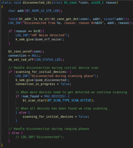

static void disconnected_cb(struct bt_conn *conn, uint8_t reason)
    connection = NULL;
    dk_set_led_off(CON_STATUS_LED);
    // Handle disconnection during initial device scan
        k_sem_give(&sem_disconnected);

int main(void){
	int err;
	dk_leds_init();
	err = bt_enable(NULL);
	if (err) {
		return 0;
	/* Start Scanning for Multiple Devices */
	err = scan_init();
	if (err) {
		return 0;
	err = bt_scan_start(BT_SCAN_TYPE_SCAN_PASSIVE);
	if (err) {
		return 0;
		k_sem_take(&sem_disconnected, K_FOREVER);
	LOG_INF("All devices detected => stop scanning");
	/* Reconnect one by one with previously detected devices */
	while (true){
			const bt_addr_le_t *peer_addr = &addresses[i];
			char addr_str[BT_ADDR_LE_STR_LEN];
			bt_addr_le_to_str(peer_addr, addr_str, sizeof(addr_str));
			const char *reflector_name = reflector_names[i];
			int device_nr = i+1;
			const struct bt_conn_le_create_param *create_param = BT_CONN_LE_CREATE_PARAM(BT_CONN_LE_OPT_NONE, 0x0060, 0x0030);
			const struct bt_le_conn_param *conn_param = BT_LE_CONN_PARAM_DEFAULT;
			if (connections[i]) {
				bt_conn_disconnect(connections[i], BT_HCI_ERR_REMOTE_USER_TERM_CONN);
				bt_conn_unref(connections[i]);
				connections[i] = NULL;
			err = bt_conn_le_create(peer_addr, create_param, conn_param, &connections[i]);
			if (err) {
				LOG_ERR("Kon niet verbinden met %s (%s), foutcode: %d", reflector_name, addr_str, err);
				continue;
			if (k_sem_take(&sem_connected, K_SECONDS(4)) != 0) {
				LOG_INF("W: Connection to device %d timed out. Skipping...", i);
				continue; // Move on to the next device
			/* Add a small delay to allow the connection to stabilize */
			// Security
			err = bt_conn_set_security(connections[i], BT_SECURITY_L2);
			if (err) {
				LOG_ERR("Security failed for %s", reflector_name);
				continue;
			k_sem_take(&sem_security, K_FOREVER);
			// MTU Exchange
			static struct bt_gatt_exchange_params mtu_exchange_params = { .func = mtu_exchange_cb };
			err = bt_gatt_exchange_mtu(connections[i], &mtu_exchange_params);
			if (err) {
				LOG_ERR("MTU exchange failed for %s", reflector_name);
				continue;
			k_sem_take(&sem_mtu_exchange_done, K_FOREVER);
			// GATT Discovery
			err = bt_gatt_dm_start(connections[i], BT_UUID_RANGING_SERVICE, &discovery_cb, NULL);
			if (err) {
				LOG_ERR("GATT discovery failed for %s", reflector_name);
				continue;
			k_sem_take(&sem_discovery_done, K_FOREVER);
			// Default settings
			const struct bt_le_cs_set_default_settings_param default_settings = {
				.enable_initiator_role = true,
				.enable_reflector_role = false,
				.cs_sync_antenna_selection = BT_LE_CS_ANTENNA_SELECTION_OPT_REPETITIVE,
				.max_tx_power = BT_HCI_OP_LE_CS_MAX_MAX_TX_POWER,
			err = bt_le_cs_set_default_settings(connections[i], &default_settings);
			if (err) {
				LOG_ERR("Default settings failed for %s", reflector_name);
				continue;
			// Subscriptions
			err  = bt_ras_rreq_rd_overwritten_subscribe(connections[i], ranging_data_overwritten_cb);
			err |= bt_ras_rreq_rd_ready_subscribe(connections[i], ranging_data_ready_cb);
			err |= bt_ras_rreq_on_demand_rd_subscribe(connections[i]);
			err |= bt_ras_rreq_cp_subscribe(connections[i]);
			if (err) {
				LOG_ERR("Subscriptions failed for %s", reflector_name);
				continue;
			// Capabilities
			err = bt_le_cs_read_remote_supported_capabilities(connections[i]);
			if (err) {
				LOG_ERR("Capabilities read failed for %s", reflector_name);
				continue;
			k_sem_take(&sem_remote_capabilities_obtained, K_FOREVER);
			// CS Config
			struct bt_le_cs_create_config_params config_params = {
				.id = CS_CONFIG_ID,
				.main_mode_type = BT_CONN_LE_CS_MAIN_MODE_2,
				.sub_mode_type = BT_CONN_LE_CS_SUB_MODE_UNUSED,
				.min_main_mode_steps = 2,
				.max_main_mode_steps = 5,
				.main_mode_repetition = 0,
				.mode_0_steps = NUM_MODE_0_STEPS,
				.role = BT_CONN_LE_CS_ROLE_INITIATOR,
				.rtt_type = BT_CONN_LE_CS_RTT_TYPE_AA_ONLY,
				.cs_sync_phy = BT_CONN_LE_CS_SYNC_1M_PHY,
				.channel_map_repetition = 1,
				.channel_selection_type = BT_CONN_LE_CS_CHSEL_TYPE_3B,
				.ch3c_shape = BT_CONN_LE_CS_CH3C_SHAPE_HAT,
				.ch3c_jump = 2,
			bt_le_cs_set_valid_chmap_bits(config_params.channel_map);
			err = bt_le_cs_create_config(connections[i], &config_params, BT_LE_CS_CREATE_CONFIG_CONTEXT_LOCAL_AND_REMOTE);
			if (err) {
				LOG_ERR("Config creation failed for %s", reflector_name);
				continue;
			k_sem_take(&sem_config_created, K_FOREVER);
			// Enable CS security
			err = bt_le_cs_security_enable(connections[i]);
			if (err) {
				LOG_ERR("CS security enable failed for %s", reflector_name);
				continue;
			k_sem_take(&sem_cs_security_enabled, K_FOREVER);
			// Procedure params
			const struct bt_le_cs_set_procedure_parameters_param procedure_params = {
				.config_id = CS_CONFIG_ID,
				.max_procedure_len = 1000,
				.min_procedure_interval = 10,
				.max_procedure_interval = 10,
				.max_procedure_count = 0,
				.min_subevent_len = 60000,
				.max_subevent_len = 60000,
				.tone_antenna_config_selection = BT_LE_CS_TONE_ANTENNA_CONFIGURATION_INDEX_ONE,
				.phy = BT_LE_CS_PROCEDURE_PHY_1M,
				.tx_power_delta = 0x80,
				.preferred_peer_antenna = BT_LE_CS_PROCEDURE_PREFERRED_PEER_ANTENNA_1,
				.snr_control_initiator = BT_LE_CS_INITIATOR_SNR_CONTROL_NOT_USED,
				.snr_control_reflector = BT_LE_CS_REFLECTOR_SNR_CONTROL_NOT_USED,
			err = bt_le_cs_set_procedure_parameters(connections[i], &procedure_params);
			if (err) {
				LOG_ERR("Procedure params failed for %s", reflector_name);
				continue;
			// Enable procedure
			struct bt_le_cs_procedure_enable_param enable_params = {
				.enable = 1,
			err = bt_le_cs_procedure_enable(connections[i], &enable_params);
			if (err) {
				LOG_ERR("Procedure enable failed for %s", reflector_name);
				continue;
			LOG_INF("Device %d: %s", device_nr, reflector_name);
			// Ranging process
			for (int round = 0; round < RANGING_ROUNDS; round++) {
				k_sem_take(&sem_procedure_done, K_FOREVER);
				distance_estimation_in_progress = true;
				err = k_sem_take(&sem_rd_ready, K_SECONDS(1));
				if (err) {
					LOG_WRN("Timeout waiting for rd_ready from %s", reflector_name);
					continue;
				if (most_recent_peer_ranging_counter != most_recent_local_ranging_counter) {
					LOG_WRN("Mismatched counters on %s", reflector_name);
					continue;
				err = bt_ras_rreq_cp_get_ranging_data(connections[i], &latest_peer_steps,
					most_recent_peer_ranging_counter, ranging_data_get_complete_cb);
				if (err) {
					LOG_ERR("Failed to get ranging data from %s (err %d)", reflector_name, err);
					continue;
				err = k_sem_take(&sem_rd_complete, K_SECONDS(5));
				if (err) {
					LOG_ERR("Timeout waiting for rd_complete from %s", reflector_name);
					continue;
				estimate_distance(&latest_local_steps, &latest_peer_steps, n_ap,
					BT_CONN_LE_CS_ROLE_INITIATOR, reflector_name);
				net_buf_simple_reset(&latest_local_steps);
				net_buf_simple_reset(&latest_peer_steps);
				distance_estimation_in_progress = false;
  • Hi
    So this message should only occur when your device disconnects, so there is something going wrong before you see this "failed to establish. RF noise?" message. I see that the ranging is quite a bit larger just before the disconnect. Could this disconnect be due to the devices being too far away from each other? At what distance between the devices do you see this disconnect exactly? Did it work for a while since you verified the answer before seeing this error again?
    Simon
  • Hi
    Simon
