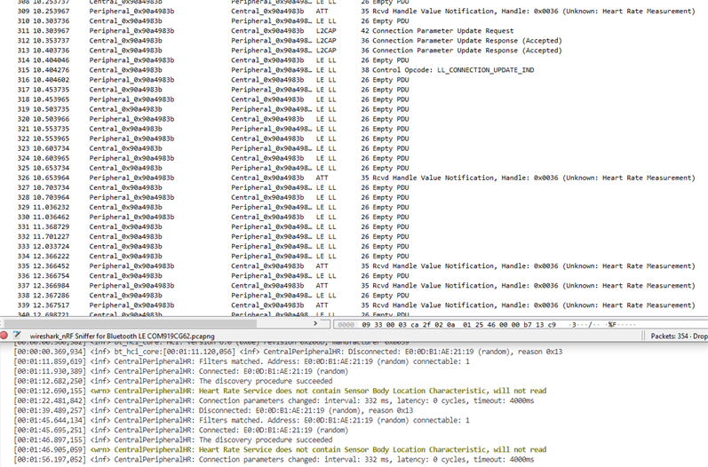

Custom board nrf5340 configured as central peripheral HR combo disconnects from HR devices after a 'successful' connection param update.
We are currently in the process of developing a custom board containing the nrf5340, which will act as a central for HR devices and a peripheral for data transfers. During the development of the HR side we came across an issue in our custom board that doesn't occur on the discovery kit. The issue is that every time a HR device has connected to our Central, and requests an update of the connection parameters, our central accepts these new parameters but doesn't use them. Thereby causing a timeout in the connection with the peripheral.
This behaviour is visible in the image below:

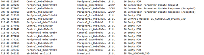

The wireshark sniffer caught the following traffic:
The central does not seem to actually use the new connection parameters, as between each empty PDU (discounting the re-transmits) is still the original ~50ms interval. Our peripheral does not accept this interval and is quietly disconnected, going back into advertising mode (which is temporarily a NONCONN).

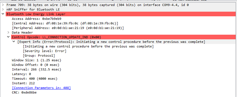

The only visible hint on what could be wrong here is in the control opcode message, which has a red error message in the protocol window, as seen in the below image:

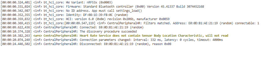

At first we assumed this to be a software issue, where our device isn't correctly setting the new connection parameters, so we went back to the nordic samples.
The above images were all taken from the Central And Peripheral HR sample from Nordic, with the authentication, security elements and DK associations completely stripped from the sample. The only addition is a le_param_updated callback, which prints out the new connection parameters. We created two build configurations, one for our DK and one for our own hardware (the dts of which is solely based on that of the DK with DK elements removed). Flashing this sample to our DK we observed the expected behaviour, as seen in the image below:
Although it takes a few packages for the connection parameters to actually update, we can see that from package ID 327 and onward that the connection interval has been changed to ~330ms and the peripheral keeps notifying the device of new heart rate intervals. Curiously the above behaviour is captured after we flashed the build configuration that was actually meant for our custom hardware, yet it still works. This would mean that (as far as we are aware) the firmware of both devices is the exact same, yet on our custom hardware it seems to fail which points to it being a hardware issue (although we do find this a strange hardware symptom).
