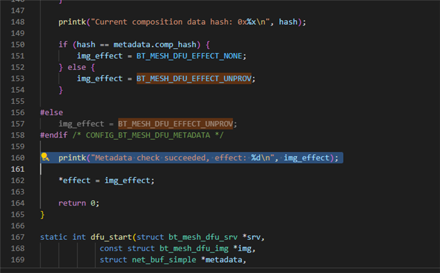

  • Good news. I have found a solution now, which is to manually change the hash value in the upgrade package to the correct hash value, then upload the modified upgrade package to the distributor, and then perform dfu normally. At this point, the img_effect will be BT_MESH_DFU_EFFECT_NONE, and the node upgrade will not become an unprovisioning device after completion

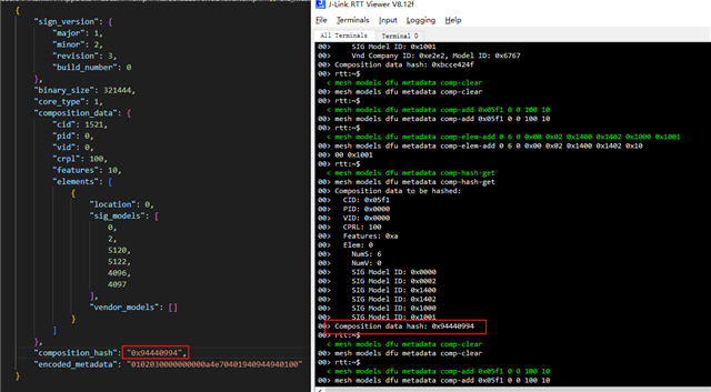

    llly said:
    The problem to be solved now is that after adding the manufacturer's custom model, the hash value in the automatically generated upgrade package is different from the calculated hash value

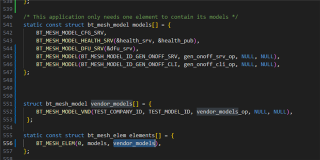

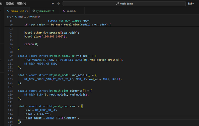

  • Not adding new models after updating, but choosing whether to add vendor customized models before compilation
    I am testing. If the vendor custom model is not added to the code, everything will be normal. If a vendor defined model is used in the code, the hash values in the upgrade package automatically generated by NCS will be different.
    But in actual projects, I need to use vendor custom models, whether before or after updates, so I am not adding vendor custom models through DFU.

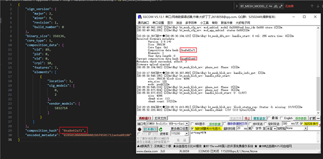

  • Firmware B only modified the version number to check if the DFU was successful.
    When adding a custom model, the hash in the upgrade package when building a is already incorrect, rather than obtaining the wrong hash after making other modifications to the firmware
    In the simplest terms, adding a custom model will result in incorrect hash values,this no longer requires DFU to verify

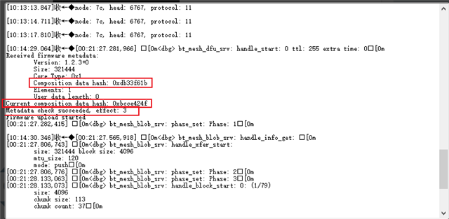

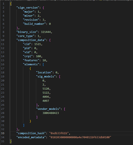

    The screenshot above shows the upgrade package obtained after adding the manufacturer's custom model. It can be seen that "composition_hash" is 0xdb33f61b,this is an incorrect value

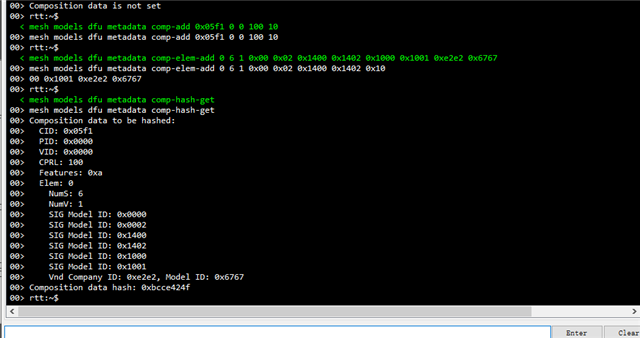

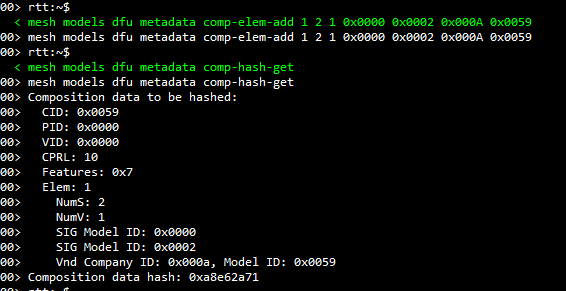

    This image is the hash value I manually calculated using the shell command. The correct hash value should be 0xbcce424f
    As long as there is a custom model, the problem of obtaining different hash values through two methods will occur, which has nothing to do with the DFU process and is a problem that occurs during construction.Is my description clear enough?
