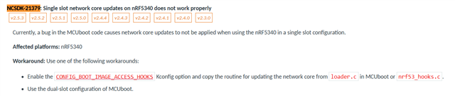

    i am using nowadays the SDK 2.7.0 and it seems the bug NCSDK-21379 still exists even if it has been removed from the list of known anomalies.
    According to the link here , the bug NCSDK-21379 should be solved from 2.5.3, but it seems not. Could I please have a feedback from you ?

  • From what I can tell, the fix I mentioned was added in v2.5.0, but then there has been a lot of changes to the same file between v2.5.0 and v2.7.0, so we cannot see the fix 1-to-1.

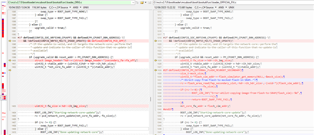

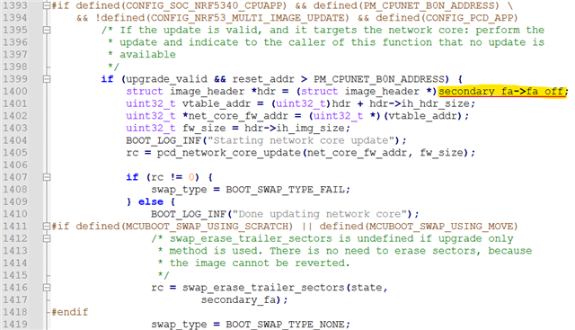

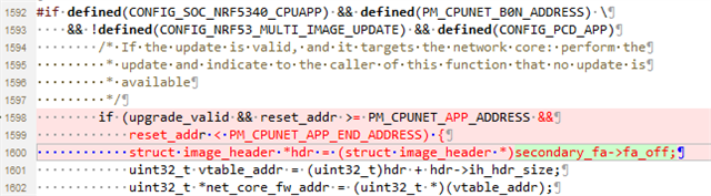

    Actually i was trying to be kind when i said "it seems not". In reality, from my tests and analysis, the problem has not been addressed. You can see it from the screen-shot i posted in my previous message where i compare the original loader.c file with the fixed one.

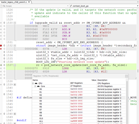

    In the original file loader.c at line 1400, secondary_fa->fa_off contains the start offset from the beginning of the external flash memory and the hdr pointer is accessing this address, which does not exist within the memory address of the nrf5340. Despite that, i could see, during debugging, that the firmware was hanging forever within the function pcd_network_core_update(net_core_fw_addr, fw_size)
