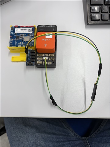

I am evaluating wether this Thingy:91x can communicate with an autopilot (CubePilot CubeOrange) or not.
What am I doing right now?
For those who might not know about autopilots, my autopilot CubeOrange has an interface called TELEM1 through which it can receive and send serialized MAVLink messages (this is the protocol that this autopilot's firmware uses for communication). I have already configured this, and set the baudrate to 57600 (among other parameters).

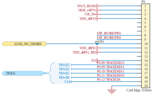

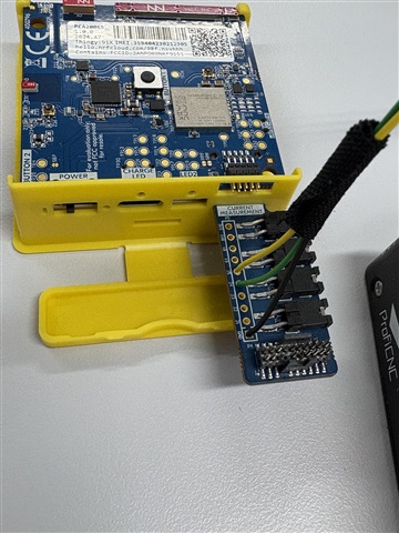

I could see in this graph below that the pins 15 and 16 from the section P9 of Thingy:91x correspond to P0.08 and P0.09 (which are the GPIO pins I am assigning to UART3 Tx and Rx from an overlay (will show later). However, since I lack of some materials and resources, I could not connect the autopilot TELEM1 to these pins 15 and 16, and I connected it to the pins 24 and 25 of the section P5 (I measured with the multimeter and realized it is equivalent, if not please tell me :)).
I wrote an overlay thingy91x_nrf9160.overlay that, among other things, configures the pins 8 and 9 to use UART (UART3 concretly).

I do not know what I might be doing wrong, but I am not able to receive any data from the autopilot.
Any help will be really welcome, thanks!
    As stated in the documentation for the thingy91x:
    The interface also allows trace debugging and connecting external circuits or boards to the Nordic Thingy:91 X™ by using the nRF9151 SiP 's TRACE pins as regular GPIOs. The pins are configured as GPIOs by default.
    So these shall be accessible.
    Have you tried setting up uart3 in a loopback configuration? Ie. connect RXD to TXD, and send a character to see if the receiver gets it back?
    Alternative is to scope the pins, and send a uart string from the nRF.
