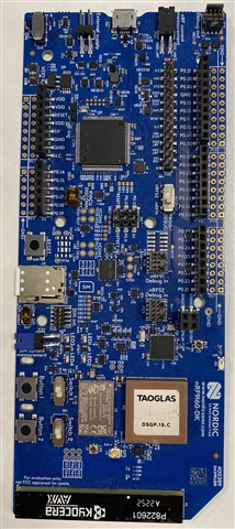

nRF9160 DK not responding to the AT commands

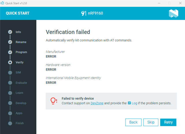

I have been working with the nRF9160 DK to understand AT commands. I tried flashing the Serial LTE Modem application using the Quick Start option in the nRF Connect Desktop application. However, I encountered an error log and was unable to verify the IMEI number or manufacturer of the modem. After flashing the modem, I also attempted to communicate with it using a serial monitor, but it does not respond to AT commands.
As an alternative, I tried flashing the Shell Command Line Interface application onto the board using Quick Start. With this application, I am able to communicate using AT commands. However, in this case, the SIM card (Onomondo) is not recognized by the board (I am using a different SIM card instead of the iBasis card).
I also attempted to recover the board using the "nrfjprog --recover" command, but it did not resolve the issue.
Additionally, I tried flashing the Serial LTE Modem application using the Programmer app in the nRF Connect Desktop, as well as nRF Connect in Visual Studio Code, but encountered the same issues. However, I was able to successfully flash the Blinky and Echo Bot UART applications using the Programmer app and nRF Connect in Visual Studio Code, and both applications function as expected.
Could you help me understand what might be causing the problem with the board? Can I conclude that it is unusable? If so, is there a method to check its usability?

2025-05-12T14:40:28.438Z INFO Opened port with options: {"path":"COM13","baudRate":115200}
2025-05-12T14:40:30.440Z ERROR Error: Received ERROR as return value from AT command
2025-05-12T14:40:30.451Z INFO Closed port: COM13

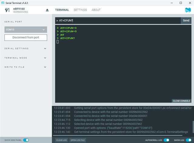

  • The screenshot of the serial terminal is attached for your review. I also tried pressing the Reset button on the board while serial terminal is connected to the board, but it didn't change anything.

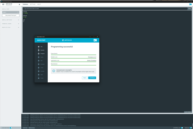

    Here is what it looks like on my side when programming the Serial LTE Modem application through Quick Start:

    I have attached the serial terminal view while flashing the SLM application using the QuickStart option.
    As per your suggestion, I have built and flashed the AT client sample application using Visual Studio. You can see the serial terminal below while I flash the application.
    But after resetting the device using the Reset button on the board, I receive a "Ready" message, but it does not respond to the AT commands.
    EDIT:
    The serial terminal settings were not correctly configured, which was the reason for the inability to communicate with the AT tracker application. I have updated the serial monitor settings as shown below, and now I can receive response from the modem. However, AT%XSIM? still returns a USIM card failure error.
    I also retried communicating with the modem with correct serial terminal settings while flashing the SLM prebuilt application, but it does not respond in the same way as the AT client application. The result is the same when building and flashing the SLM application using Visual Studio.
