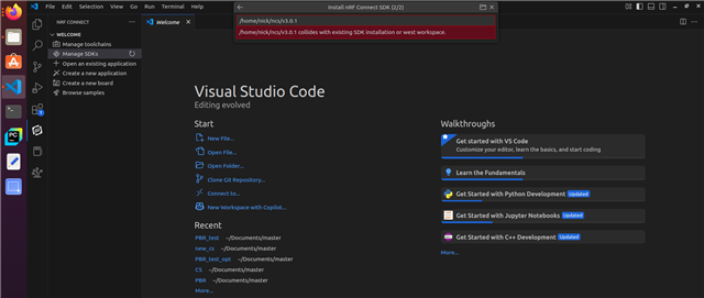

    Thank you very much! I have just tried to install the SDK 3.0.1 aftfer i installed Toolchain 3.0.1, but this problem was occurred:
  • This means that there is already something in the folder called `/home/nick/ncs/v3.0.1`.
    You could:
    1. Download the SDK to a folder with a different name.
    2. Delete that folder and try redownloading the SDK.
    I accidentally did the same thing and the second solution worked for me.
