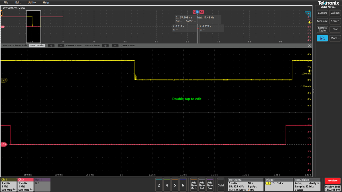

Nrfx_qdec double trigger for one turn
I am having an issue with the nrfx_qdec driver in zephyr, I am trying to simply detect when the turn happens and the direction of the turn is.
Most of the time this is triggered fine, but sometimes for one turn of the encoder I get 2 triggers, I am trying to figure out how I should best debounce this, whether in the qdec configuration
or something on the my side in data_ready_handler for example.
I am using NRF connect SDK v2.9.1 in VScode
MCU is nrf52810_xxAA_REV2

Should I be reading the sensor differently or configuring it to debounce? It seems that the double turns happen within under 100ms of each other.

    Gave this a try and still no luck, even with counting a 4 transitions for a single detent still getting incorrect events sometimes. I will add I have watched the quadrature signals on a oscilloscope and they seem to be clean and as expected even when I get these multiple triggers for one step of the encoder. I also don't think that debouncing will solve my problem now as turning the encoder very slowly can result in 3 or more triggers at any time for one step of the encoder.
    Not sure where to go from here at least on using the qdec peripheral side.
    Here's a screenshot of the oscilloscope when I got a double trigger. Signals look as expected in my opinion.
  • Hmmm... can you try to use sample-period = 3 (1024us), also enable debouncing (NRF_QDEC->DBFEN = 1) in any case?
    The only thing I can think of is that thode edges as not as "clean" as we think.

  • I somehow think there are some doubling transitions occurring here, but I am surprised if they are not handled. I guess you can simply try to directly read the NRF_QDEC->ACCDBL register and check if it's set:
    https://docs.nordicsemi.com/bundle/ps_nrf52810/page/qdec.html#ariaid-title34
    My suggestion externally is that you for instance add a small capacitor on the pins, because on the screenshot you shared I can see some ripples, though I don't quite understand why they should cause transitions.
    Kenneth
