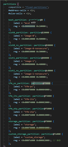

    The reason that the external flash is by default required is that in many case if you want to update the network core it's not possible to do that with the internal flash as you will not have enough spare space to receive both the application core image and the network core image.
    It's possible to do DFU with the internal flash but then you have quite limited flash size and you can only update the application core which is not ideal.

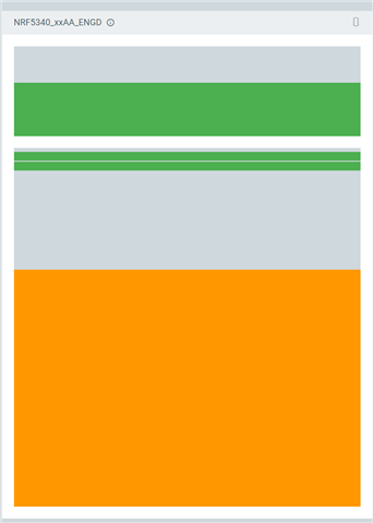

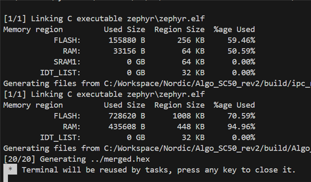

  • This is the size shown when the project is built.

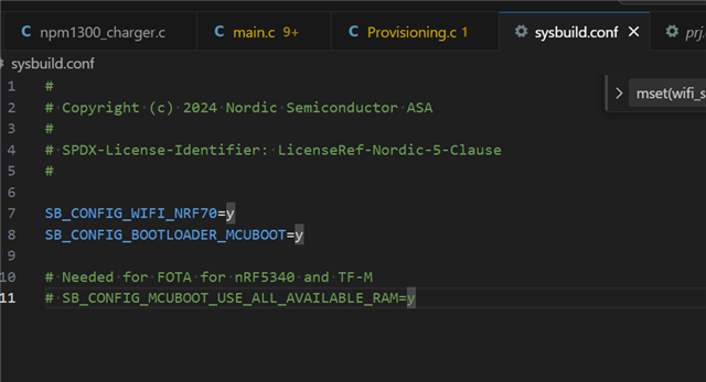

    (I disabled SB_CONFIG_BOOTLOADER_MCUBOOT=y in sysbuild.conf because enabling it caused a flash overflow error.)
    In that case, it seems that using external flash is essential for implementing OTA reliably.
    If I use external flash, will the flash overflow error disappear when SB_CONFIG_BOOTLOADER_MCUBOOT=y is enabled?
    If you disable SB_CONFIG_BOOTLOADER_MCUBOOT , the DFU option is removed. This may explain why you don't see flash overflow.
    Yes if you use external flash it will free up half of the internal flash (that used for receiving new image) for the application. So you will most likely have enough flash to fit MCUBoot and your application.
