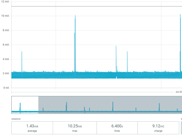

    What i need to confirm is that does the DFU get effected if the device goes into low power during the connection of exchanging the MCUmgr parameters.
    Because the DFu starts it tries to read the MCU params and times out and doesn't go into any fault.
    Following is the current usage during the mobile app connected:
    Whereas this is with a one second apart advertisement:
    Thanks

    Sorry for getting back to you a bit late. From the shared configurations and images, I believe you are entering System ON mode, which means BLE plus DFU should work without any issues.
    I’m not sure about your application implementation, but if your application doesn’t force the system to enter System OFF mode, then I think it should work. None of your screenshots indicate System OFF mode, so I believe you are not implementing that in your application.
    The issue you are seeing might be because the DFU requests are timing out due to the system not waking up fast enough. Try adding a delay after the BLE connection is established before entering sleep mode. This is to ensure the device doesn’t go to sleep too soon, which might interfere with DFU.
    Abhijith
