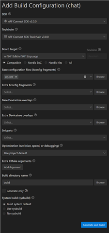

I'm trying the mesh chat example, but I can't build it. This is the error. Thank you for your help.

    FATAL ERROR: command exited with status 1: 'C:\ncs\toolchains\0b393f9e1b\opt\bin\cmake.EXE' --build C:/ncs/v3.0.0/nrf/samples/bluetooth/mesh/chat/build/chat

  • Hello Hieu,
    Thank you for your reply. I built the example using this configuration and made no further changes.
  • Hello Ethan,
    I see now. The issue is due to setting prj.conf explicitly. When a configuration file is set explicitly, the build system doesn't search for other config files, and therefore the important boards/nrf54l15dk_nrf54l15_cpuapp.conf file wasn't included in the build, causing the issue you are seeing.
    Refer to: Setting Kconfig configuration values.
    There are two ways to fix this:
    1. Add the boards/nrf54l15dk_nrf54l15_cpuapp.conf file as an Extra Kconfig fragment or a second Base configuration file.
    2. Don't specify prj.conf and use build system default.
  • Hello Ethan,
