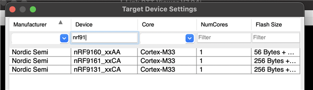

  • Ok, but when I open JLinkRTTviewer, I don't have the choise to select nrf9151 I only Have these chip
    Can I use nrf9161 for 9151 ?
  • What version of JLink? This is what it looks like for me

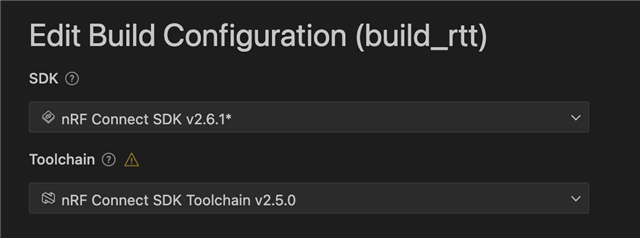

  • Ok thanks, but now in vscode I don't have the snippet nrf91-modem-trace-rtt?. Can I add to my prj.conf/
    CONFIG_NRF_MODEM_LIB_TRACE_BACKEND_RTT=y
    CONFIG_USE_SEGGER_RTT=y
    CONFIG_NRF_MODEM_LIB_TRACE=y
    Is it the same as the snippet?
