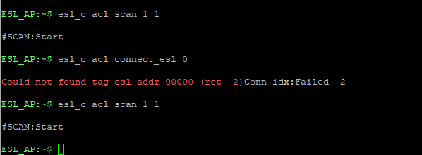

    Here are the commands I use in the central shell:
    esl_c acl scan 1 1          // Establishes sync with the peripheral
    esl_c acl connect_esl 0     // Attempts to connect to the peripheral with address 0000 (fails if CONFIG_BT_SETTINGS is enabled)

  • Ok, so I tried using the peripheral from your previous reply (NCS v2.9.0), and the nrf-esl-bluetooth\samples\central_esl (both with CONFIG_BT_SETTINGS=y included and commented out with NCS v2.5.0), but nothing happens in either case. Do I need to adjust anything? Note that I moved the shell from cdc_uart to uart0. Does that change anything? Is it dependent on connecting the USB or something?
    When I tried to run your commands I got:
    In the log, it said:
    But do I need to specify any addresses or something?
    Note that this is with CONFIG_BT_SETTINGS commented out.
    Edvin
  • You can leave the central config unchanged (so also with CONFIG_BT_SETTINGS=y). The problem is only with the peripheral. When executing the esl_c acl scan 1 1 command the central scans for peripherals and syncs with them automatically, though this can take a couple of seconds. This works in the current implementation. When executing esl_c acl connect_esl 0 the central tries to connect to the peripheral with PAwR address 0. This fails if the peripheral has CONFIG_BT_SETTINGS enabled and succeeds otherwise.
    So first check that the peripheral and the central have established a PaWR sync, then try to restablish a connection, then the error should happen.
