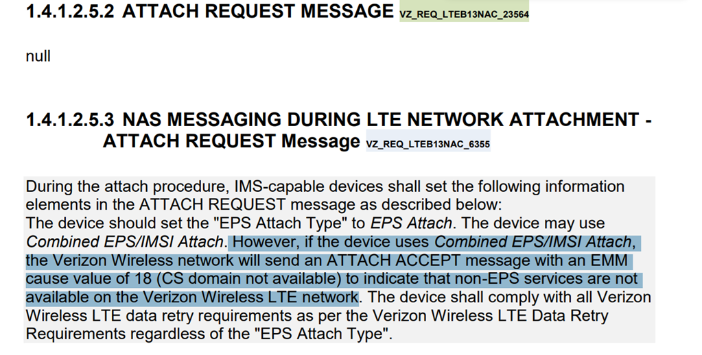

In our device logs, I observe the following lines when using Verizon. Take note of the line in bold.
+CEREG: 1,"Redacted","Redacted",7,0,18,"11100000","11100000"
[00:00:06.579,101] <wrn> lte_lc: Registration rejected, EMM cause: 18, Cell ID: Redacted, Tracking area: Redacted, LTE mode: 7
01-01-1970 00:00:06.579 MODEM: (sysworkq) LTE Registration: Registered Home

From my research, this is normal and expected behavior for Verizon. Per Verizon documentation (See highlighted part):
EMM cause 18 definition per 3GPP TS 24.301 V19.2.0 (2025-03):
Cause #18 – CS domain not available
This EMM cause is sent to the UE if the MME cannot service an UE generated request because CS domain is not available and SMS in MME is not supported.
Question 1: Is my understanding of EMM cause 18 correct, and can you confirm that it should have no impact to the network performance of the nRF9151 modem when using Verizon?
Question 2: Why does the link controller library log "Registration rejected, EMM cause: 18" when the registration was successful but the network doesn't support the legacy CS (Circuit-switched) domain? For someone not intimately familiar with the attach process, this can be confusing.
Question 3: Can I manually set the EPS attach type to "EPS Attach" instead of the default of "Combined EPS/IMSI attach?" Is there some disadvantage to doing this if so?

  • Hello Derek,
    The spec you have provides is from IMS-capable devices and our device is IMS-less
    We do combined IMSI attach (EPS attach type IE) with “SMS-only” (additional update type IE). This combination should work just fine.
    Our experts think that they may be something incorrect with your Verizon subscription, so you should probably take it up with them as well.
    Michal
