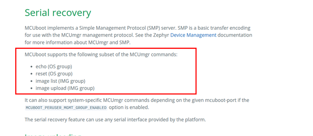

    Only a limited subset of the mcumgr commands are implemented in serial recover mode (https://docs.mcuboot.com/serial_recovery.html) and the update is expected to be uploaded directly to the primary slot.
    Both slots show bootable=false
    This seems to be a limitation when using serial recovery mode. The flag is always shown as false.

    1. The flag is always shown as false in serial recovery mode
    2. 8 ('MGMT_ERR_ENOTSUP') indicates that the command is not supported/implemented.
    3. Does the bootloader not boot the main app on normal boot when you are not entering serial recovery mode?
    4. I can't think of anything that should be relevant. I also tried to test it here now to be sure, but it worked on my end. Difference is that I uploaded the image directly to the primary slot (-n 1).

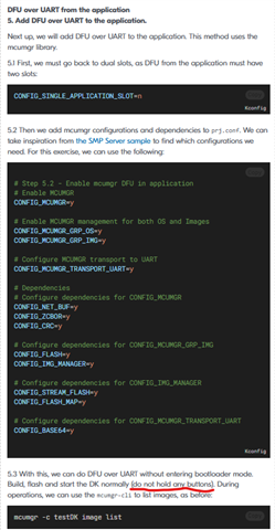

  • Hi Vidar,
    Thank you for your response. I followed all the instructions at the link you provided me with for DFU via the app, but when I try to run the 'mcumgr ... image list', I get an NMP timeout, so I'm unable to test or confirm the new image. I am also unable to successfully run 'mcumgr ... image upload ...'. Below is my prj.conf:

    Do any of my configs interfere with the ones needed for DFU over UART? I can confirm that setting
    CONFIG_UART_CONSOLE=n in prj.conf does not fix the problem (it is however set to 'n' in mcuboot.conf). If you do not see any issue here, do you have any idea as to what could be causing the issue? Thank you in advance.

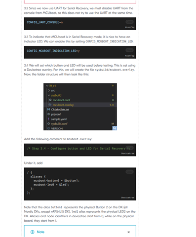

  • Hi Gabriel,
    It sounds like maybe the board was not in "serial recovery" command when you sent the command? Button 1 on the DK must be pressed on startup to enter serial recover mode.
    https://academy.nordicsemi.com/courses/nrf-connect-sdk-intermediate/lessons/lesson-9-bootloaders-and-dfu-fota/topic/exercise-1-dfu-over-uart/
    Vidar
  • Hi Vidar,
    I am trying to do Section 5 of those instructions (DFU over UART from the app):
    As you can see, I am supposed to be able to do DFU without pressing any buttons/entering bootloader mode. However, this is not the case. For my application, I cannot use a single application slot because in the case of an interrupted DFU, the original firmware will be lost. Thus, it seems required that I do DFU over UART from the app (with CONFIG_SINGLE_APPLICATION_SLOT=n).
    With this said, do you have any idea of what my issue could be?

  • Hi Gabriel,
    Sorry, I thought you were still trying to perform DFU within the bootloader (serial recovery), but you clearly stated in your previous response that you were attempting it from the application now. From the projec configuration you posted it appears you've based the application on the peripheral_uart sample which uses the UART interface for serial port emulation. The problem with is that the 52832 only has one UART instance in HW which can't be shared between the app and mcumgr. Is it an alternative to perform DFU via BLE instead?
