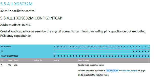

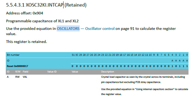

I have a question about the following registers:
・XOSC32M.CONFIG.INTCAP
・XOSC32KI.INTCAP
For these, the reset value is as follows in the data sheet:
I checked these two registers with nrf54ldk, but they were not the reset values.
How is this value determined?
For example, output a specific frequency from the IC and check the actual measured value with a spectrum analyzer. If the measured value is significantly different from the expected frequency value, adjust it by changing the register setting.
