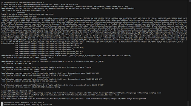

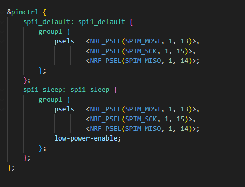

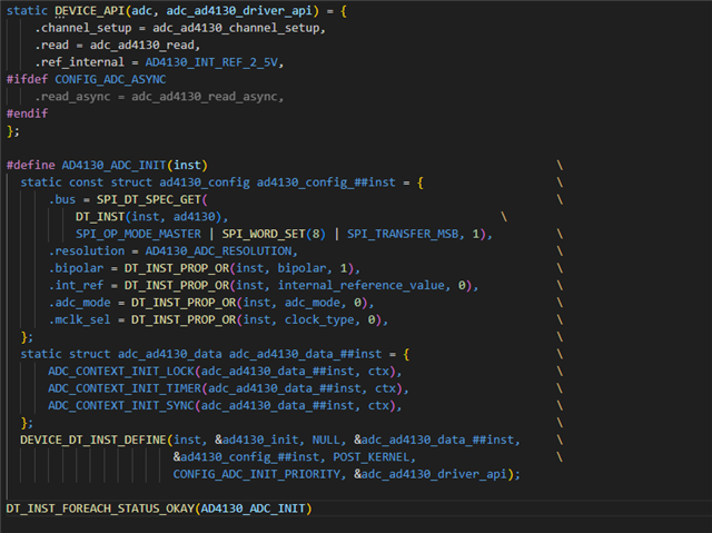

I'm working on developing a driver for the AD4130 ADC in Zephyr and I'm facing issues related to the device tree binding integration. Specifically, it seems the chain between the .yaml binding file, the overlay file (.overlay), and the driver source code is not functioning correctly.
The main problems are:

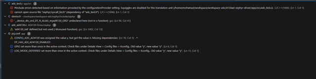

  1. Device Tree Macros Not Generated
    The expected macros such as __device_dts_ord_*, or alias macros like DT_ALIAS(myad4130) are not being generated or worked automatically during the build, even though my overlay and bindings seem to be defined.

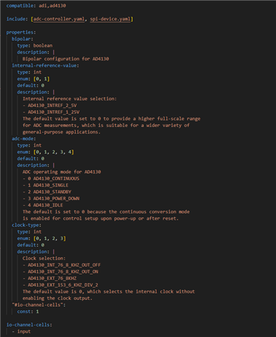

  2. Binding File Errors Are Not Caught
    When I make a mistake in the .yaml binding file (e.g., invalid syntax, wrong indentation, or incompatible structure), the build system does not report any error. It silently ignores the incorrect binding file, making it very difficult to debug.
I suspect there might be a misconfiguration in the way my bindings are integrated or that Zephyr is not correctly locating or parsing the .yaml file.
